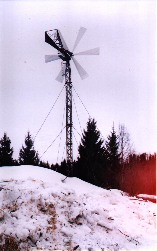

I've been involved myself
in a project of building
a wind turbine utilizing
a car wheel bearing.
Quite similar as the folks
on this board are doing.
Here is a picture of that one.
It is owned by Taisto Suihkonen,
The blade is 3 m in diameter.

I like your machine ! is it an illusion from the picture or are the blades wider at the tips ?

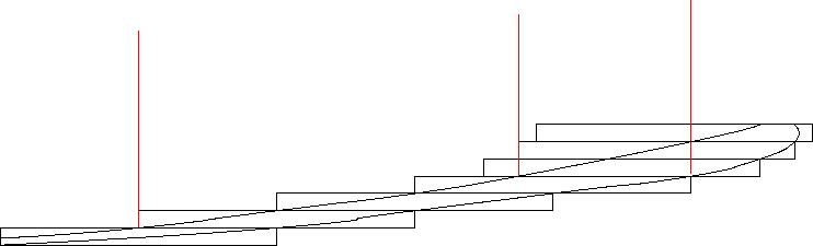

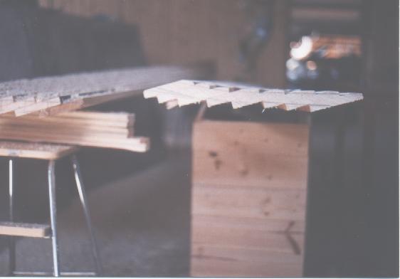

No illusion. They are wider on the tips.
The method how we made them
is available in my 'diary' here.
The reasons, why we made it like this:
1) It is very easy to make the blades
twisted by this method.
2) We are suspecting that they might be
more powerful especially on slow wind
speeds, if the blades are made wider
on the tips than on the roots.
It is based on the new
GGS theory (by Gorlov and others)
claiming that the fluid or the air
is moving towards
the tips of the rotor,
when the rotor is rotating.
3) We wanted the wind rotor to work
efficiently on really slow wind speeds.

Here is my drawing, how you
can easily cut air foil
profiles on the tips
of the blades if using
seven straight boards.
In fact I've copied for
Erkki pictures of
K2 profiles as found in the Net.
This drawing of mine here was
an early one to show to Erkki,
what kind of idea I've got in my mind.
And this is a picture of 'the original
Reinikainen wind turbine'. With my
friends we got a lot of inspiration
from this one.
It was made by a man called
'Reinikainen'. The diameter of
the blades is 6,5 m.
It has been working more than
ten years now. The generator
is a Swiss made permanent
magnet generator with a
high gearing gearbox.
The highest power seen
coming out during a storm
was more than 20 kW (1).
That is in my opinion a proof
that these kind of blades
can work efficiently
even with high wind speeds.

And next two pictures a week ago in the
workshop of Erkki. I hope to be able
to visit him during the weekend
to see, if the blades are already
ready...
We are making it two bladed
as that old turbine has been originally.
The diameter of the blades is 10 m.
That turbine had originally also
a pitch control mechanism,
but Erkki is going to fix
the new blades without using
that system. I will later send
also pictures of the method
how we will fix the blades.
As you can see in these pictures
here Erkki has just started the work
cutting the blades.
We later made exact paper copies
of K2 airfoils using a computer
printer to scale.
An original small paper copy of
a K2 airfoil is on the top of the blade
construction in the first picture.

    # Some questions: What kind of tip-to-tower distance do you have?
    'The original' six blade machine
    in the picture has got really rigid blades
    and does have quite big tip-to-tower distance.
    I might get that knowledge
    from Kyösti Juvonen,
    who is taking care of that machine.
    (There was a small mistake above,
    The wind rotor is 7,5 m diameter, not 6,5 m)
    The one we built with Taisto Suihkonen
    has got the blade a bit tilted
    and about 60 cm
    distance.
    That blade is also very rigid.
    The new one with Erkki Nousiainen
    (10 m diameter) is going to be
    fixed on a downwind turbine,
    where if the blade happens
    to become a bit flexible,
    it cannot hit the tower.

    # What kind of furling mechanism
    does that machine use ?
    The six blade has got
    no furling mechanism.
    The generator there
    is a bit oversized
    and there is an electric
    control mechanism
    to add more load,
    the more power there
    is available.
    The machine has been
    in use more than
    ten years and survived some storms,
    so that one has been
    successful without any
    furling systems.

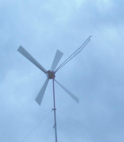

    The four blade machine with
    Taisto Suihkonen has
    got a similar furling system
    as used by Hugh Piggott
    and with the later 'OP' projects.

    With Taisto's machine
    the blades were soaked
    with linseed oil as much as the wood
    would take in. On the top
    there is an oil paint coating.
    On the tips there is fiberglass
    resin also.
    With the six blade machine there
    is a paint coating and
    fiber glass resin on the tips.
