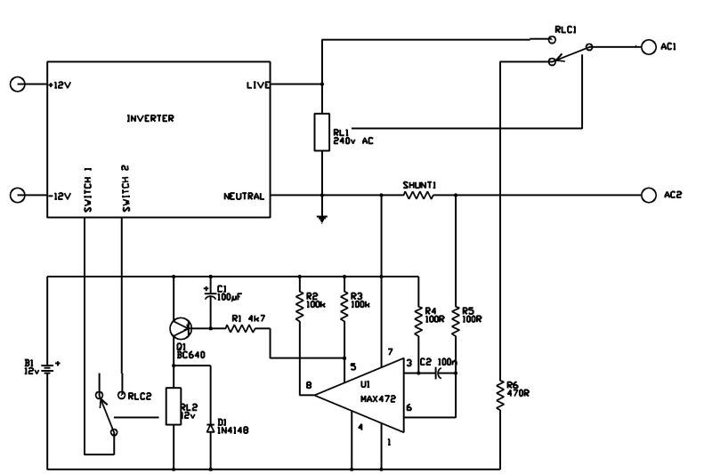

The preliminary circuit is shown below. I will try and post a better drawing when I can suss out how to get a decent jpeg or pdf out of my PCB software.
The Max472 is not fussy about the value of the shunt and in fact any old bit of wire will do! The circuit does not need to be calibrated so the resistance is unimportant. I used a 6 inch length of 1.5 mm cable in the test setup and this could probably be shorter. The only criteria is that it must be able to carry the total load on the inverter without a significant voltage drop. The leads from the shunt may need reversing if the sign output does not go high when a load is applied. The 12 volt sense voltage is applied through relay contact RLC1 which also isolates the output of the inverter.
When a current flows through the shunt the sign output of the MAX472 goes high which turns on Q1 and operates the relay RL2. The contacts are wired across the on/off switch of the inverter and so the inverter is switched on. Relay RL1 which has a 240 volt AC coil operates as soon as the inverter supplies AC, disconnects the 12 volt sensing voltage and connects the output of the inverter to the load. The shunt senses the current drawn by the load and relay RL2 remains operated. The current through the shunt is now AC and this causes the sign output of the MAX472 to turn on and off at the the AC frequency which would cause the relay RL2 to chatter. Capacitor C1 keeps Q1 turned on as the sign output turns on and off so the relay remains permanently operated.
When the load is switched off, current flow through the shunt ceases, the sign output of the MAX472 goes low and turns off Q1. Relay RL2 releases and switches off the inverter. Relay RL1 releases, disconnects the inverter output and re-connects the 12 volt sense voltage again ready for next time.

How about using a vdr (voltage dependent resistor) for your 'across the load' resistors ? One with a low resistance at a low voltage and a high resistance at a high voltage would do nicely. They are also known as 'varistors'. I don't know how to spec them, but in principle this should work.
Another alternative would be a very small 120V bulb across your load (< 1 W), pretty much the same effect (low resistance when cold, high resistance when on).

Thanks for you comments. I did look into varistors but all the information I found would suggest that they have the reverse effect i.e their resistance decreases with voltage. They seem to be used for suppressing voltage spikes on power supplies to protect sensitive equipment etc. Your suggestion of a low wattage bulb sounds like something worth following up though. Thanks!

it's a positive voltage coefficient (sp?) vdr that you want. (most are 'mov's, metal oxide varistors or 'tranzorbs' or whatever brandname they use and are indeed spike protectors, but the other variety exists as well).
An old colour tv should get you some, disc shaped ceramic pieces with wires attached to the sides and lots of colours indicating their value at room temperature and pos or neg coefficient. Usually in or near the HV power supply, not to be mistaken for capacitors because of the colour coding (but they look a lot like ceramic caps otherwise)
