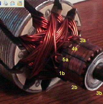

watching my little windmill spin and I guess the first thing is to do a little data collecting on these few little blower motors for car heaters and AC's I just gotta figure how to make little generators outa them the easiest way possible.
   There must be some of you out there that are using them for little generators even if they are just putting out enough to charge a couple of NiCads and light up some white LEDS would be cheaper than buying 4 magnets and making a Pico Turbine just to light up a couple of red and green LED's ....
    Well I!m off to my cold shed to see what kind of output I get when I spin one of these critters at about 1750. (After I remove the blower of course)
  Here is a view of the armature....
I was wondering....there looks to be room enough for 2 or 2 and a half as many turns would that make an very significant difference in the output?
        Thanks for the help guys...I just know some of you have considered experimenting with these motors...there so cheap and plentiful its a shame not to exploit their potential.
        Any enthusiasm on this will be more than welcome.
                 ( :>) Norm

 Yes that is what (view5) looks like ...a lot of air and
 laminations...some copper...just enough so it will work for
 a year or two....relies on laminations.....steel is cheaper
 than copper. I plan on keeping it simple maybe double or just
 a little more windings if there is room.
Maybe I'll make an endplate that will allow for easy acess and
 replacement of the brushes...plus a roller blade bearing(they
are a loose fit on the shaft, an easy fix) all of this plus
advancing or retarding the brushes slightly. Should accomplish
 the goal.
   If this works out I might even buy (gasp) some wire to rewind some armatures...if I run out of microwave wire that is....
          Thanks for the support Zubbly...I kinda
           figured on you replying.
              Hope you are having as much fun as I am.
                                  ( :>) Norm

they can be rewound as a 2 pole machine, filling up all the available slots, then connect one end of the coil to all of the commutators, and taking power off of the brushes and then ground the other end of the coils to the shaft, then you fabricate a brush to pick up the other lead that rides on the end of the shaft.
i wouldn't be surprised if one would produce two hundred watts with a good fast prop
i think most of them use about twenty amps or so as a motor which equals around two hundred plus watts

   Sounds good...right now I'm just learning trying to figure how to rewind it the regular way and just doubling the windings I'll be happy if I can get about 50 watts from it ...we only get about 15mph winds here and then a VAWT will be driving them for now.
   But what you describe sounds interesting, can you go into more detail and sketchs or pictures?
   I've only rewound one of these motors and seems like I may have done it wrong, even at that I got positive results! So it's encouraging...
              Thanks a Lot Bob!
              ( :>) Norm.

    Ever rewound an armature? I've only rewound one of these (few of those 3 pole armatures on those hobby motors for slot cars that my son used to race when he was a kid ...don't really count)
    I discovered that this blower motor that I r ewound was wrong...so after unwinding 2 of them and looking carefully at the third one before I unwound it.....I was looking where the winding ended up and Hey! it ended up on the opposite commutator bar also....
......DUH! Must be Two coils wound simultaneously ....
  So you're not the only one that thinks himself  stupid!
  So I think I've finally got it figured out right!

OK. Got my motors here. Some of this is pretty basic, but I always considered these as throw-aways and never looked too close before.
They look wound with 'about' 25 turns per coil. 2 coils per slot. Coil 'A' goes from slot 1 to 5, coil 'B' goes from slot 5 to 9.
Coil 'A' lookes seriesed with coil 'C' in slot 6 to 10.
A quick look, and I thought I'll just add series wire to the coils, instead of stripping the fine job they all ready did.  You know, add more turns to theirs.
Here is where it gets wierd.  There seems to be no start or stop to any of the wire, like a single loop without ends!
Each contact has a wire come from a coil, loop around, then off to the next coil.
OK, just found the well hidden ends.  But given the nature of this thing, I don't know if I will be able add coils.  There is not a lot of 'extra' wire to solder on more.  And I'm not sure I'll be able to figure out which contact goes to which coil.
A meter isn't going to be much help.
I would be a lot easier if the brush contacts (forget the word right now) were a half inch farther from the coils.
I'm guessing 30~35 additional turns of my new small microwave wire would be spiffy.  Too high ohms maybe. Not enough space in the can ends maybe.
This is the only possible revelation in this whole post... The placement of the coils to magnets to brushes look like there is some canceling issues. I hope I'm wrong.
The loops are crimped in the copper. Maybe uncrimping them will gice a little room to work. A guy who works for me is good at this tiny soldering in small spaces stuff.
I see yours has the same loops at the contacts.  Mine has straight slots.  I think I have more turns of a little smaller wire, hard to tell from the photo.  This one has the big flux band inside the can, 1/8" thick.

   I'm going to rewind it in the stock configuration first...it was wound
in pairs 1a was wound first, then it is turned 180 degrees and 1b is wound, (clockwise) you can see that the wire was looped around 1b tab then advanced to the 2slots that would become the coil of 2b....just as you can see how the wire was advanced from 4a tab and started in the 2 final slots for coil 5a.
   I'm trying to explain this so a newbie at rewind can follow this and see how it is done...then if sucessful it'll be a project like zubbly and others have done with plastic pipe props.
    It would be nice to get about 60-75 watts even half that at about 600 rpm heck even gear it up and spin it at 1200rpm.....whatever we'll see.
    I'm going to try for 35 turns of this wire .025 inch stuff for my first try there is possibly room for 45 turns.
     Let me know if you think my explanation would be clear to someone just starting out at rewinding.

       My first rewind of these things I thought it was wound with one wire so I just followed the pattern and went right around ....didn't know what I was doing but it worked....still don't know what I'm doing  Oh...Well!
