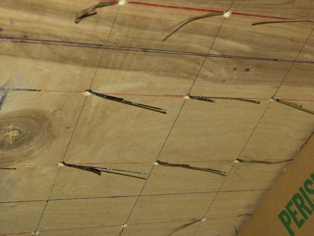

« Reply #6 on: January 18, 2005, 06:29:04 PM »
just a shot of  a couple props..
steep angle at the hub then tappered off to the tip...
no numbers---just made a line from hub to tip..and went from there..
with a airfoil on backside...
