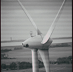

I've been admiring Enercon blades for awhile - some are very low speed (17 RPM) and gearbox-free designs that get up to 370 feet diameter. I thought they borrowed many aspects, esp the root area, from great whales. None of the images I surfed off the web have details high enough to see leading edge clearly but a few hint of tubercles. Some show hints of perpendicular grooving after the leading edge though.
