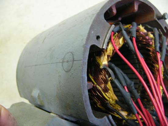

« on: July 20, 2005, 10:32:26 PM »
had this motor laying around--had it on my old moped for awhile--it was a real juice hog..it had field winding in it--i checked the field coil stringth by hooking a 12 volt batt to them--not to impressed week magnetic stringth--so i tossed in 8 ceramic mags from lowes..put the motor back togeather--hooked it to a 12v auto batt--it spun up even more with the mags then the fiel coils--puts out some great amps but low volts--just by testing with my hand drill..should make a good gas powered gen..
heres a picture of it frying a couple of wires--powered by a hand drill..
any way it was a real easy conversion...most power ive seen from 8 ceramic mags!!

Re: field powered motor to pm motor
« Reply #1 on: July 20, 2005, 08:30:43 PM »
Hey, that's pretty neat.  I wonder how much the armature and brushes can handle current wise.
Have you considered trying it the other way with a permanent magnet armature and using the field pole shoes to extract power?
BTW:  You might be able to increase the voltage by playing with the phasing between the magnets and brushes.  Try rotating the brush holder end of the motor in relation to the magnets.
« Reply #2 on: July 20, 2005, 09:07:25 PM »
it has- bosh-300watt-on the side of it..might be an old VW gen..it had a bent shaft on the back side--which i sawed off..also it has 4 power out bruches on it-2for plus and 2 for negative output--real heavydudy type....
i tried putting mags on the armuture[using a diffrent motor]-and using the field coils for output--not  much power at all...
i have some old 1950s auto gens--might try replacing the field coils on those with mags--and see what kind of motor or gen -i get out of them................
« Reply #4 on: July 21, 2005, 01:28:09 AM »
thanks for the info..
hooked it up to my briggs and stratt.--nice to have electric start--just bypass the rectifier-to start..works great for that-as of now i just need a bigger pully on the engine--other wise i have to have it throttled up kind of high to reach past 12volts.
i guess i kind of lucked out on those mags --they were just the right size to go in there...wasn"t any real hassle at  all to change it over..just take out the field coils and glue in some mags..and you end up with a pm motor or gen...............later.
« Reply #6 on: July 21, 2005, 06:34:25 PM »
Which indicates that the magnets you put in were weaker than the field-coil system.
DC motors speed up until their spin generates a voltage that almost matches the voltage applied across the commutator.  (The amount they fall short controls the current.  The current controls the force pushing the rotor around.  Load it, it slows, the current goes up, the force goes up, and it stablilize at a lower speed, drawing more power.)
Lower the field voltage and you speed up the motor.
This is/was a big problem with large wound-field DC motors.  If they lost field excitation they'd speed up as the field collapsed, sometimes reaching hysterical speeds that would tear up themselves or the equipment they drove.
Of course as the field goes down the maximum force they can put out also goes down.  But on the big ones even the residual magnetism could keep them delivering enough horsepower to keep accellerating after all the field current was gone.  If they were hooked to something that presented an intermittent load - like a stamping mill - which wasn't presenting a load just now, they could spin up the flywheel and tear it apart, throwing the massive chunks all around the plant.  Very hazardous.
« Reply #7 on: July 21, 2005, 11:20:47 PM »
no.. the negative bruches are grounded--tried series -no go....
still puts out more power than before --no dou"t..
as a gen it works great--haven"t checked the amps yet--waiting until  i put a bigger pully on the engine--right now their the same size--as a electric start it spins my engine right up--real torkey...
« Last Edit: July 21, 2005, 11:20:47 PM by hiker »
« Reply #8 on: July 21, 2005, 11:32:12 PM »
i hooked the field coils directly to a 12volt auto batt..the mags still had WAY more pulling power.......it has no field coils now.
all i know is that it has more tork--and more rpms..its going to be used as a gen..and electric start for the engine..
so no worry about over speed--unless of course i crank up the throttle on the engine..
works for me :}.......................................................................
« Reply #11 on: July 22, 2005, 02:43:20 PM »
the coils were on the small side -in this motor-so i dout if it would work out to be a better way to get power from this motor...like i said the mags have WAY more pulling power than the field coils ever did...heres a pict. of a 2 pole conversion using the field coils as output --it still needed lots of rpms do get any power from  it..
most likley would have worked better if i replaced the field coils with mags..
