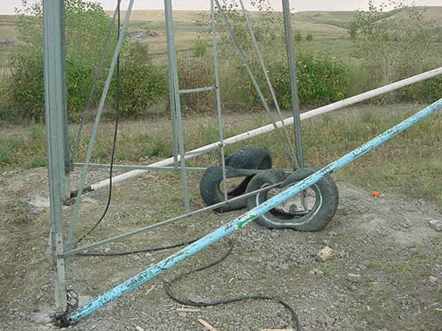

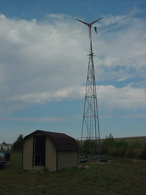

I finally got my 40 foot, 3 legged Wincharger Tower built  with swivel legs and anchors cemented in.I've raised and lowered it about 5 times with no problems. Today was first time with Wind turbine attached.
It went up perfect!
I use two tires to absorb the impact but one tire would probably do.
The best wind we saw today was about 12 miles an hour but I was seeing 9-10 amps at 51 volts! I was very pleased so far. However I have the extension pipe up at 6 feet over the tower, in gusty winds that seems to rock the top of the tower too much, so I will lower it about 2 feet to get the weight down closer to the tower. I also for to put a clamp on top where the cable comes through the pipe so I have the weight of the cable pulling on my stator, not good.
 We are situated in a huge valley, although quite high up on the side, we get lots of wind throughout the whole valley, so should be good.Today seemed to cap off a very satisfying journey of bulding your Wind turbine from scratch, then seeing it rise up to meet the wind and gracefully start turning. I'm gonna have one stiff neck tomorrow!

   Was also looking at the top, where you said, you were going to lower the support pipe -- won,t that put your blades, dangerously close to the tower ??
   Perhaps you could just add a larger pipe, part way up the original....
   Anyway , really nice -- wish I had one just like it!!!  Bill H..

Thanks Bill, I didnt use the driveshafts, but I did use driveshaft yokes with solid pins going through for the back legs to pivot on. I dug the holes just over 3 feet deep,then belled out the bottom so top of hole was about 12 inches wide and bottom was about 18 inches. Then I took 6 foot steel posts and drove them downinto the hole above 4 more feet. Then right beside them I had some heavy Iron, not sure what it was used for but it was 'S' shaped,I attached it to the steel post with some old logging chain. I then attached 3 or 4 cultivator shovels to this apparatus.I also put in a seperate post with an eye hole on top to attach a safety chain to each leg. Then all the holes were filled with cement.The back legs pivot in 4 inch channel Iron. The front leg sits in channel iron and gets bolted down.
           I can lower the top pipe at least a foot, maybe two without running into a clearance problem I think.I wonder what the minimun clearance should be for 70 inch laminated cedar blades?They dont seem to flex much, but in a 60 mile an hour wind? Also today I'm pounding in a couple steel rods (5/8 inch by 5 feet) into the ground for ground rods.I'm wonder what size cable to use for a ground cable? I have old welding cable, booster cables,Will something like that be enough?

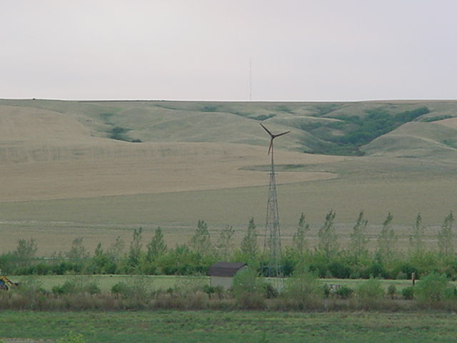

Shadow, in your 4th pic there seems to be a tower on the horizon, is this a comms tower?

Yep, Communication Tower. There are 4 of them within about 5 miles all around 500 feet tall. I wonder if they'd notice if I put a wind turbine on one of them?
