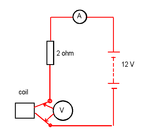

I managed to find your previous post, it looks as though it was Windstuff Ed who asked for the resistance but for any meaningful tests you need to know it.
Unfortunately your meter is not good enough to measure the low values, you need to do it by a volt drop method. Connect your winding in series with a resistor to a 12v battery and measure the current flowing and the volt drop across the coil, then use Ohm's law to find R.
Choose a resistor about 2 ohms so that the current will stay within range of your meter on the 10A range. Use the meter on the 10A range first to measure the current in the circuit, then remove it( the current change will be negligible so assume it is as before). Now put your meter on volts and connect across the coil to measure the volt drop. To avoid measuring volt drop in the connection to the leads supplying the current, connect your voltmeter directly to 2 bare patches on the coil leads not to the external wires.

I am still not sure on resistance Flux , is this correct
I take voltage reading at a specified rpm then using a 2 ohm resistor I take another voltage reading at the same rpm then with these 3 variables I can figure out resistance .
Is this correct? I have a lack of knowledge in this area.....

You could measure resistance this way as there is no reactance but it would be easier with a battery and a lot more accurate. Hope this sketch explains it.

that drawing is just what I needed , thankyou! , you probably already posted it ten times but if you did I didn't see it-lol
