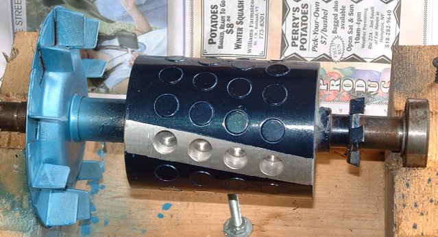

I discovered that the magnets can be set in to the armature and removed, or at least shuffled with a bit of trial and error.
I attempted a couple configurations of magnets and had some results that were surprising until I turned the motor at higher RPM. Of course the best configuration is the one I haven't yet tried :)
With 2 poles of 4 magnets each I could spin the genny @ 2200RPM and barely make 13 volts rectified DC. 2 poles of 12 magnets was up to 40 volts and 2 poles of 20 magnets brought it up to over 90VDC.
This is with the main windings wired in series, through a full wave rectifier bridge and no load. I found out that you have to spin the armature @ 2500+ rpm to throw a magnet and it amazingly didn't hurt a thing in the motor. Just a bit of the nickel coating scratched up on the mag. It would be nice to have a tach to figure the cutin speed in series and parallel.

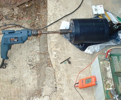

Here is all I have to test with at the moment
The drill is only a cheep 1/2" from sears and the best I can turn the genny with a battery attached is about 8 amps. As the drill heats up and the old dead battery begins to take a charge my drill keeps slowing down. as close as I could figure rpm with my meter, at 1080 I had 23.96 volts @ 7 amps for about 175 watts.

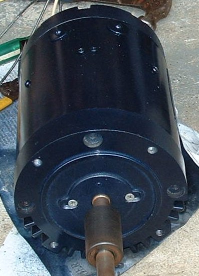

I decided that some automotive paint would seep in beside the magnets to help hold them in place and protect them from the elements.

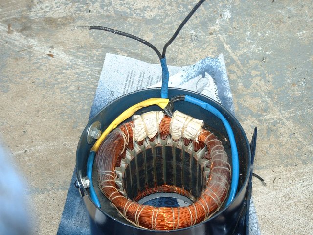

The final wiring turned out to work best with both coils in series. I soldered and heat shrank the leads together. the other 2 were the start winding which were isolated and shrink wrapped.
Gotta love dollar store paint. This is a GM blue from plasticoat.

Have you cnsidered using the start windings seperately?
Garbogen style.
« Last Edit: October 12, 2005, 09:24:00 AM by ghurd »

I did think about running 4 wires down the tower and possibly using the start winding for charging a different set of batteries. I almost pulled them out today to see just what I could get out of them with a load hooked up.
The problem I have is that while I may be charging 15 to 19 volts on the main it would still be below 12 volts on the start winding, or at least there was about a 50% difference when I was no-load testing. I thought if nothing else, perhaps I would light a few led's with that winding so I could see at a glance how it was turning at night.

You may be able to seperate the starts into 2 halves then series them?
Most of my starts are a huge number of turns of smaller wire, meaning they should cut in faster.  It's not like I do anything normal, so I could be wrong.
But I can help you out with the LED idea if you want. Cheap and easy. No problem.
