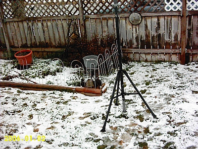

My first mill goes up today, !!!

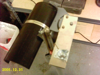

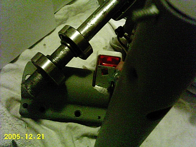

I made mine using two bearings on the yaw, with a caster, (bearing) on the furl.
I scored a Mini test tower from brother-inlaw last weekend, !!! 7' tall, fold-up !!!
I'll post many pic's later.
Will run thru "FlexCharge", "NC25A/12", with Dump being portable heater, (120 VAC Converted).
My Furl and Yaw will show that I saw what others did and had to do it my way.

I see that my caster bearing wheel furl mount needs tweeked.
It was sitting in full furl this morning. lol
I'll be leaning it back and or adding a spring or two, to get it to un-furl.
O-well, it's just a idea, to keep me from showing how little I remember about welding.

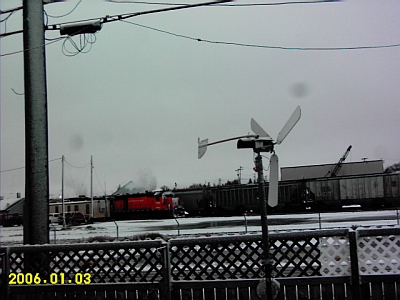

I just set-up the Ametek  mill again, with a spring to un-furl.
MAN that thing chases the wind gusts, maybe to much bearing on YAW.
I was watching and saw the tower pick-up a leg and quickly pulled it down again.
I'll reset it after I run the wires up thru tower tube, (was thinking about using extention cords, bolth wires for Pos & another using bolth wires for Neg. They are 16 Gauge rated @ 13 Amps. Will this be safe?)
I"ll also set the GUY lines this time.

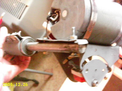

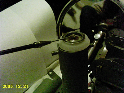

I only used a small caster for the furl.
For the YAW, I used two bearing that had a solid shaft running thru them.
I stuck it down a small pinch tube, and also used a old HD bearing for the shaft to sit on. I drilled two holes thru shaft for mounting the gen to.
Pictures will show.

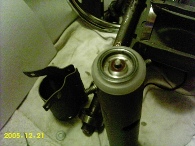

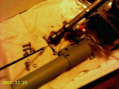

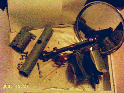

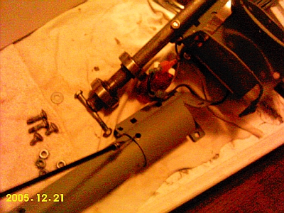

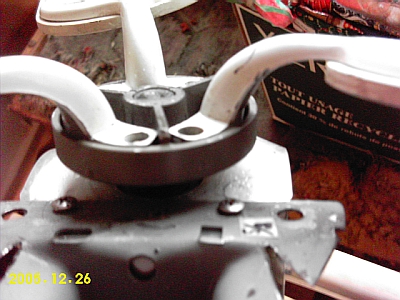

Parts started with.
Should get power.
should turn.
« Last Edit: January 04, 2006, 08:27:26 PM by coldspot »

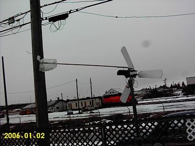

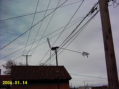

Tower for test
After test night
« Last Edit: January 04, 2006, 08:36:00 PM by coldspot »

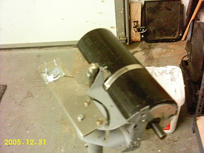

« Reply #13 on: January 05, 2006, 04:43:25 AM »

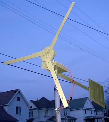

Ready 4 furl
Trying to get 45`
After test night and found FROZEN in full furl, I'll be tilting this back about 25`
Was an easy match 4 blades after thin ring attached to only three points on hub broke off with 4' "Zub-Woof" blade attached to ring, (wasn't even flying, rolled off seat in truck after powersliding around corner on iced road, MAN I love only one thing about winter and thats slick streets, must mean I've been driving same truck to long)l

Still not showing?
O-well
Frozen in full furl after test night n storm. Will improve un-furling!
A look at my furl mnt.
What I used for prop.
« Last Edit: January 06, 2006, 10:15:21 PM by coldspot »

Yaw and mounting parts
Just using what I had

coldspot
  • Posts: 843
Re: Ametek 30 VDC Mill
« Reply #31 on: January 15, 2006, 05:08:57 AM »
Tail or Rudder size and length of setback?
How it looks now with tilt down on tail.
To much?
To little Tail?
To far back?
just a different pic on tail showing how far back and size.
Just seems to chase the wind around alot.
maybe to many YAW bearings?
« Last Edit: January 15, 2006, 05:08:57 AM by coldspot »
$0.02
« Reply #32 on: January 15, 2006, 06:42:33 AM »
I would guess the tail is too small and too long.
"chase the wind around alot"
Partly from the smooth yaw bearings?
Looks like you could have my problem. Too much turbulence.  Last night the one I posted above faced north and the LEDs light up, violently faced south and the LEDs light up, then north, then south...  The wind was from the west side of the house.  Amazing it didn't tear the blades off (securly fastened with a loop of duct tape!).
