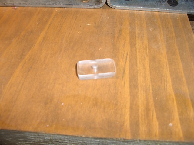

A made littel 1/4" plexi pieces to wind the coils on. They are the same shape and size as the magnets (just a pinch longer).

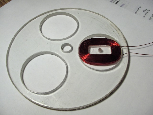

This is a 4 magnet 3 coil 3 phase pma. To make it quike and easy I've simple cut three 2" inch holes in a 6" diameter X 1/4" thick plexi disc. The coils will lay in the holes in proper alignment . There will be a 6" diameter disc 1/16" thick glude to iether side to holt the coil inplace. 1 cap first then coils then some reson then the other cap the skwish and set.
Heres the pix of the littel plexi coil ceneter pice. I've cut 10 of the littel pieces and I'm just leaving in the center and gluing them inplace with the coils.

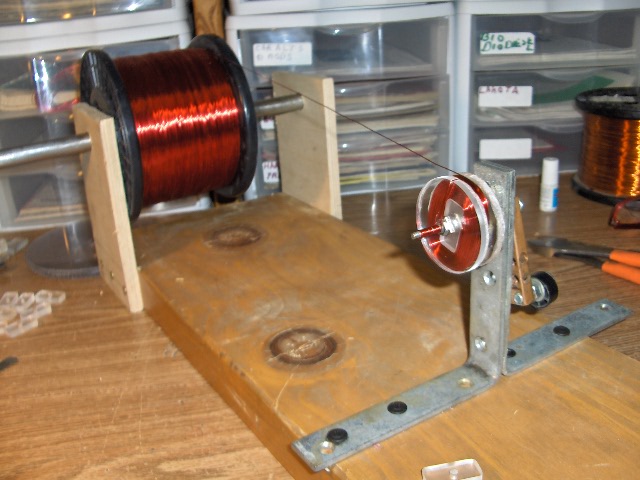

Here is the coil winder.
Here is the plexi stator form with coil inplace.

I'm building a small test dual rotor alt as discribed above. This alt will have 3 changable stators. One stator has 200 turns of 24 ga wire (delta/jerry riged). As per my wire gage ? from a couple days ago, as you and others stated 21 gage is twice the circular mills of 24 ga.
I'm hoping that 100 turns per coil will fit stator #2(star). Flux has sugjested stator #3 should have 116 turns of a wire gage that apears to be between 22ga and 21ga. This is a half size or a metric size? Thats the question. Stator #3s 116 turns is to compesate the normal star stator for its 1.73 X delta diferance.
I think I'll use the 22 ga. for stator #3 cause thats what I have and if 21 ga will make 100 turns in the space I have 22 ga. should make the 116 turns Flux has requested.

Just did a dc measurement on the 21 gage coils. Accounting for the test leads .05 ohms
The coils (116 turns of 21 gage) measure .56 ohms. This would then give 1.12 ohms between any 2 star legs.
The delta coils (200 turns of 24 gage) measured 1.81 each.   This will then equal .603333 ohms for delta/jerry riged.
« Last Edit: February 19, 2006, 06:08:23 PM by Jerry »
