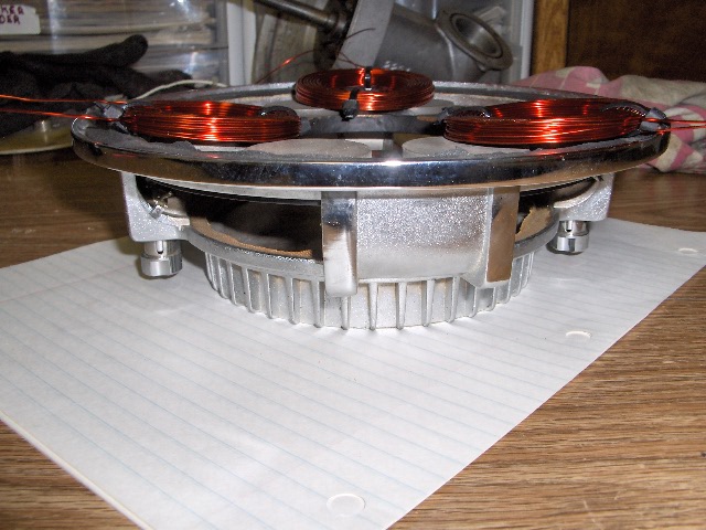

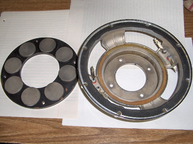

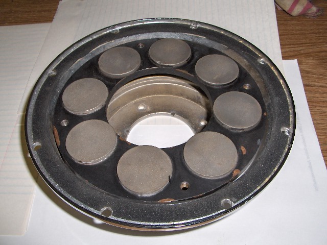

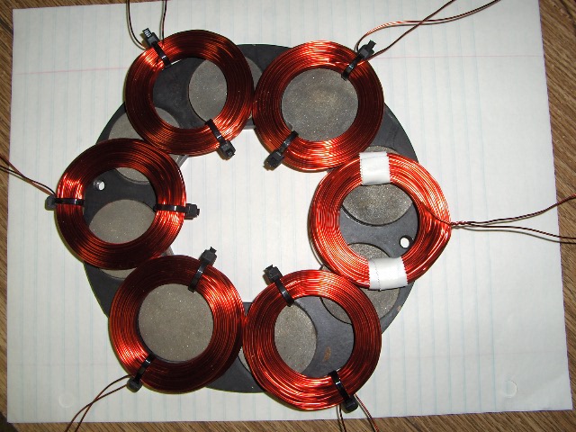

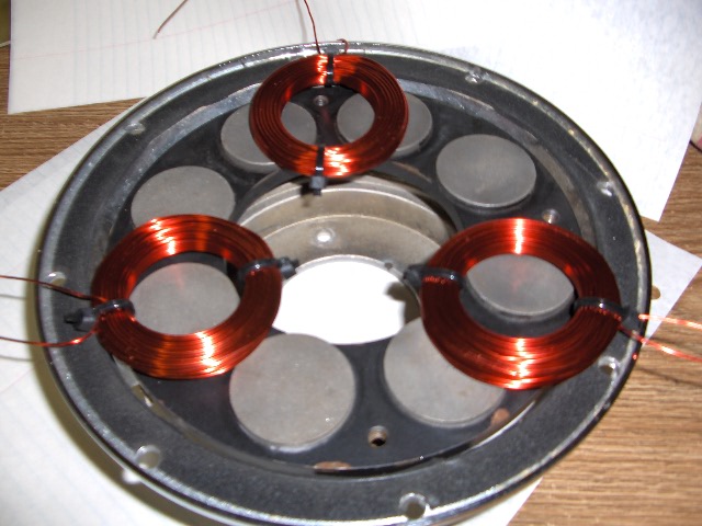

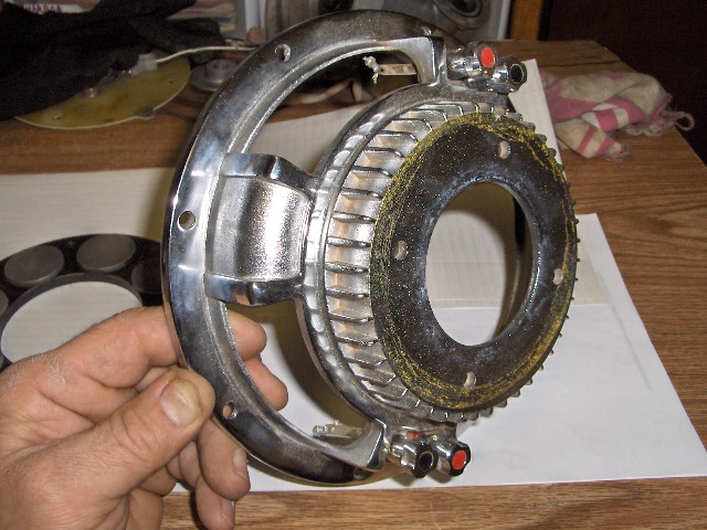

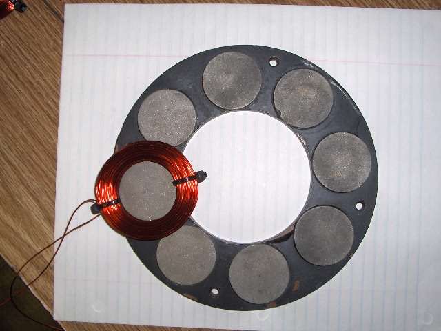

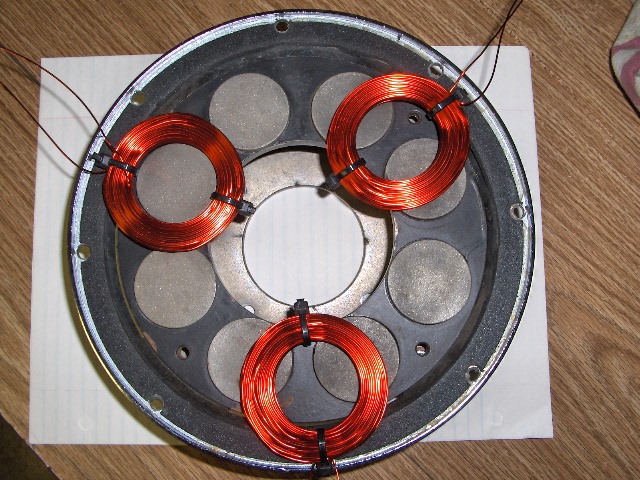

I'm going to use an 8" cast speaker basket to support the fiberglass wafer stator.
I did this with my Lowes 10" ceramic alt. It worked so well I thought I'd try it on this littel alt.
Heres a group of pictures no time to detail pix now. Maybe tommorow.
Sorry about the rush. I'll try to discribe pictures tommorow.

I'm building a couple new dual rotor disc alts.  One is an exact replica of the 8" dual rotor genny except it will have 150 turns of 20ga wire as aposed to 250 turns of 22ga. wire.
I think this should satisfy the star folks as to the extra turns star needs to overcome its voltage losses.
This alt will be wind tested directly against the jerry/riged alt with the same blade.
These are both 9 coil 12 magnet alts.
But first I want to finish this littel 6.625" 8 magnet 6 coil alt.
I did a littel work on the rotor today. The rotor is glueing tonight.
I'll post more pix on the littel guy with progress.
