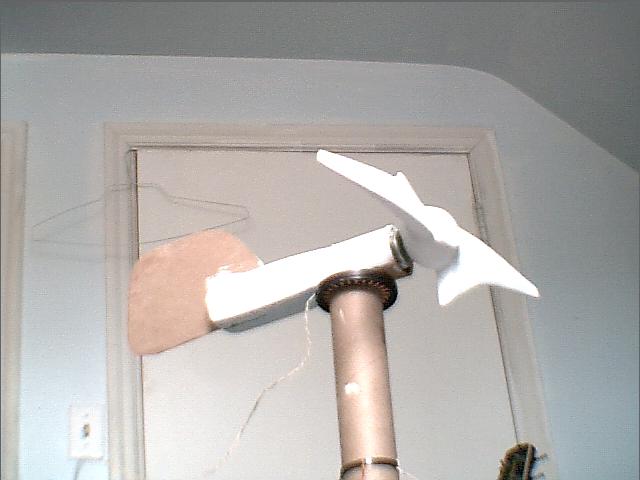

Tonight, 50 mph with gusts to 70 mph
Took the blades, OFF of my Ametek 30 VDC!!!
Busted the ceiling fan blade mounts as
far as I can tell in the dark with 30 mph  50 mph
snow blowing.
I was asleep, girlfriend came in and asked me
if I took it down, "cause the tail is still up but
blades look gone".
So I put on some long johns and a robe
grabbed slippers and flashlight
When out back to see, not much.
Snow was building up to about 3".
Hope to find them today after sun comes out.
I knew my "Furl" was getting a bit bent off to one
side and didn't take the time to  repair or redesign.
To many other mills in the ready n waiting for tower.
Did score an other tower leg set friday night, so things arn't
ALL BAD. LOL
Just when I finally ran the wires out of the crawl space
to the outside of house and was planning on re-guying
one guy wire to get it off the ground and on the side
of the house, with the wires going to the tower with it.
Learning as I go. lol! :(

The Ametek Mill.
After the 70 MPH Wind!!!
The next Morning. :(
In the next door neighbors back yard!
Still NO sign of number three! :(
Closer look at the broken end! :(
After this I'm putting a wind pressure flap type
switch on all mills!
It will work as an auto shutdown with manual reset!
Resetting a switch to work a relay will be a lot easyer than
replacing blades and hubs!!
