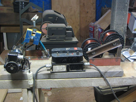

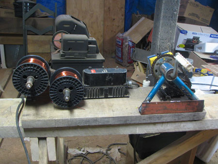

Here are some photos of the coil winder my Dad built for our wind turbine.
He used the peddal assembly from a kids bike and spring tension for the spools.
On the left you should see the DC motor and 34:1 gear box. The variable speed controler is in the center.
I'm still waiting for the counter that I ordered to arrive before we start making the coils. When it arrives all we should really have to worry about is strait windings.

Looks like a really cool setup, there.  Funny thing is that those wire spools look EXACTLY like the spools for the wire feed welders at work!!
* wanders off wondering if the wirefeed wire is actually insulated on the outside and how to get one of the 44 pound spools out of the shop without getting caught if it is!! *

it looks super strong and torquey. i'm not shure what the pedal/ crank is for ?(power outage) that would be a good area for the counter.you will need a wire guide to help keep the wires (dual wire capable thats cool)runing parallel as you lay it on the spool. the wire tensioners are slick!

That is a cool set up, Take a look at my file at the coil counter and see if some thing like that will work for you as well.

Yes, I was wondering about the calculator setup. I read somewhere about wind speed indicators made from old calculators.
We also thought (after it was built) that we probably should have used round disks for the die instead of square to help reduce snagging the wire.

If you open the calculater and carefully soilder a small wire to each side of the equell, then you can put a micro switch or reed switch or any switch, 1 + and it will keep track for you. it's great.
