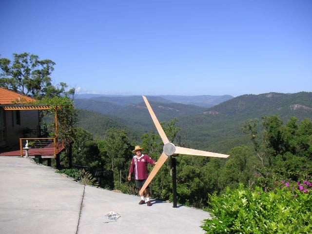

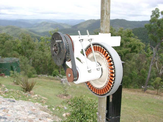

« Reply #1 on: April 11, 2006, 08:13:13 AM »
Very nice !
what is the gear ratio ?
does the cogging hurt the start up ,with the gear ratio?

nice job bruce...... makes me want one and i dont mean wind mill. (i mean the location i am totally green with envy) are those cog belt and gears if so what was your sourse?thanks for the post &pics..............johnny

Looks very nice indeed!
Personally I'd have a little doubt about the belt; the sun in Australia shines brightly (so I'm told). You have experience with using rubber belts in the open (wind/rain/sun)? Or do you plan to replace them at regular intervals?
A 'shroud' (like e.g. over the chain of a bicycle) might help a little to protect against UV exposure.
Peter.

 Nice job! What size is it? What kind of wind speeds do you get? What output are you looking for? How big is the one you have up? I see you cut the tips on an angle does this do something for performance, or is it just for looks? I wish I had a wind site like yours. You are in some nice clean air! What voltage do you run? Feel us in we would like to know. Do you have a furling system?

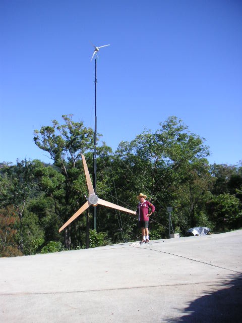

SmoggyTurnip
  • Posts: 294
Re: My new Oregon Pine blades
« Reply #5 on: April 11, 2006, 09:51:09 AM »
Maybe it's just the picture but it looks as though
the blades have a larger angle of attack at the
tips than at the root.  ie - the blade at 3 o'clock in
the first pic looks almost horazontal at the tip.
Is this just an illusion?
« Last Edit: April 11, 2006, 09:51:09 AM by SmoggyTurnip »
« Reply #6 on: April 11, 2006, 03:01:45 PM »
 I was a bit fast in posting the pic's and forgot the explaining parts.
So,
The new blades are 1700mm long (5foot4 inches approx),the root area ai around 7 inches wide and has a 2 inch drop,the tips are around 2 1/2 inches with no or very little drop. the angle at the tip is around 30 Deg. this was cut after I read about this being a fast and low noise angle(that is to be seen).
The timing belt is a standard car type(but shorter) the gears are 2:1 (common). the cogging ,I hope, will not be a problem with such a large powerful set of blades-On thistest stand, I can move the the system with just a very light touch to the outer tip of the blades.
I will make a cover-Job No.4372,hahaha.
I live at 1000 feet looking down to the pacific ocean on one side and to the far border ranges on the other-,we call it "Paradise",.
PS  No,it's not for sale.
