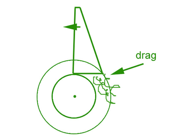

A few things I can think of. Without seeing the blade I'm guessing but see below image.
The trailing edge of the blade is located at a larger diameter than the lead edge at the root. The void being dragged around is causing drag.
The aspect ratio is too low(length to width), increase length.
Surface is too rough.
Mike

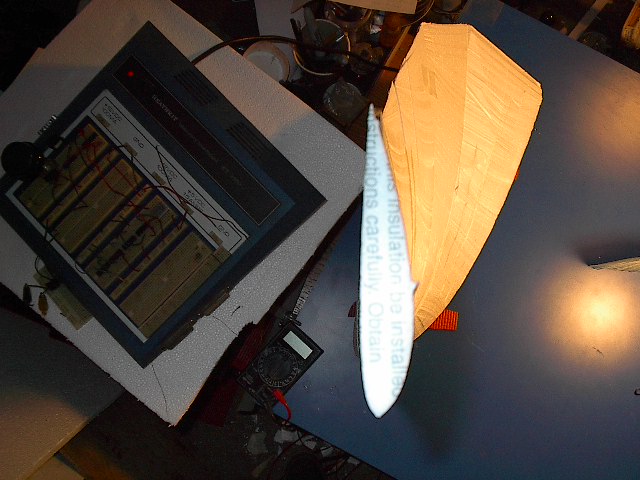

just these grins
below is seven of nine sections, standing vertical the eighth one is in front , and the ninth hasnt been born yet
this is a good shot of the twist
this is a good shot of the leading edge
still havent sanded them yet though
