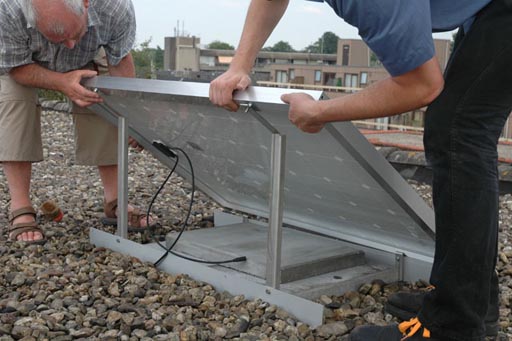

Living in an urban enverinment in a rental apartment, wind is no option whatsoever, I'm afraid. Still wanting to produce at least a part of my own energy, I had to look for something unobtrusive, silent etc.: Solar.
So, I saved money (took a while), found the best deal, fretted over it for some time, and then just did it.
After the back-breaking work of hauling 300+ kg of material to the roof the installation was a breeze.
A few pictures:

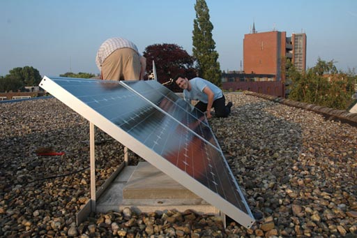

Installing the first panel (Sharp 185Wp)
The smiling guy: that's me

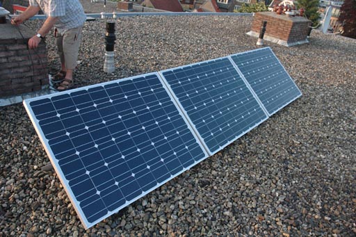

Alle three panels installed

Looks like a good setup, though, judging by the shadows being cast in the second picture, I hope they are pointed in the right direction.
Looks to be an evening installation, and the panels appear to be facing South-East, yes?

The panels our pointing due south. It was quite late in the evening and the sun was very close to setting, that's why the shadows are looking 'wrong'.
It's a flat roof, so I had complete freedom in locating the panels.

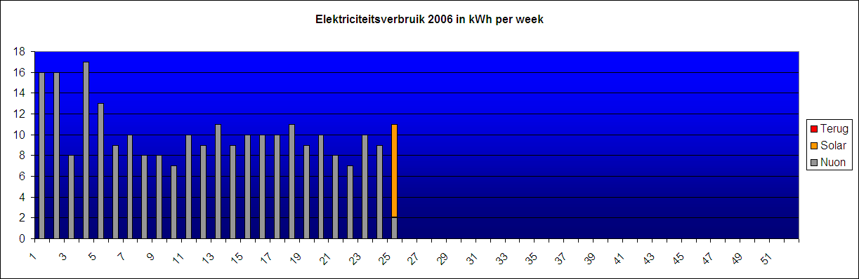

The first week with the panels on the roof has past:
Used 11kWh this week, produced 8kWh with the panels. That's over 80%! And they did that while the weather wasn't really sunny. Can't wait until the the summer really arrives, then we should see some serious kWh's!
