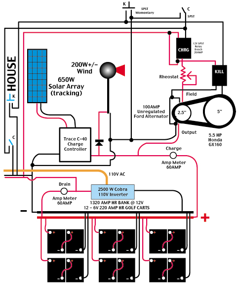

Hey Everybody,
Dinges, I don't have a digital camera, (I know and I do web design) so I thought I night try this:
If this is too small I can send larger via private email.
Anyway, this is how I have things right now. Many small parts are not shown, like fuses on batteries, volt meters in house, AC distribution box etc.
So here ya go.
RogerAS

Hi Roger,
Looks very nice, more or less the standard setup, I think. Bit of solar, bit of wind, gas generator backup.
Was primarily interested in a picture of your gas genny, but there's no hurry. The design for mine is more or less beginning to evolve in my mind. I notice you've used a 5" pulley on the engine and a 2.5" one on the alternator. Rheostat control is a bit crude in my opinion, but works fine, and a great solution for the electronically-challenged people :)
You seem to have a limited RE system (still, better than mine, I have none...), so either you have very limited power-hunger or are you still partially on the grid?
Maybe with a bit more wind (say, 1kW) you could really reduce the need for the Honda genny as a backup.

Hey,
No, we are absolutely 100% off the grid. Yes, we are very starved for power at times, like now when it's so feakin' hot. Our long term goal is to have 1.5Kw of solar and about the same for wind. I'd also like about 2 times the battery bank, and maybe a real inverter, or 2. If that was in place I don't think the engine would be an issue at all.
I've tried the homepower mark8 design a couple times and I must be doing something way wrong 'cause it keeps blowing the power transistor after a few hours. I can't figure it out, so I stay with what works.
I've often wondered if I couldn't just use the rheostat and a 555 to time pulses to a big mosFet. I never have tried though. Maybe this winter.

your going to kill that honda-lug a engine down and they wear out quick..
try at least a one to one with that 5 hp--i would  go with a slightly bigger on the alt and smaller on the engine..and make sure its turning in the right direction or you will burn out the brushes for the field coil...built a number of car alt setups over the years--got the idea from a 1960"s popular mechanics.................good luck.
Sounds like it's overheating. Lick your finger and touch the case of the transistor. If it sizzles it's too hot.
I'd also be fitting a diode in reverse parallel with the transistor (Kathode to emitter) to catch the back emf from the field when the transistor switches off.

Overheating could definitely be an issue.
Have you tried to use a different transistor, if only from a different brand? I understand that lately a lot of bogus parts show up, made in the People's Republic of China. Like 2N3055s that are way below specs and won't survive long. Maybe the same happens with MJE2955s. Perhaps try a completely different supplier from your usual one.
That back-EMF diode is a good idea, will immediately add it to the schematic.

Hiker,
Look real close at the image agian. I have a rheostat between the supply side of the positive going to the field and the field connection on the alternator. This engine has several hundred hours on it and it's still real strong. I can apply full load to the rotor, or just a hint. Yep, I know about the fan setup and all that. My sig file (notice change from bunny ref) tells all. This ain't my first rodeo! I can switch the field off and shut down the engine from in the house. Nice when it's nasty out. Too bad it doesn't have electric start.
I used to have a Kabota EL300 one lung that was never right after a rebuild by a non Kabota mechanic. I miss it, but wish I had put all that money into PV's and good magnets/wire. When that engine was good I could start, control throttle, engage charge and shut down from the house. Now I have to go out and get everything going manually.
Try the factory pulley and a rheostat on the alternator. It works. Of course you need a non regulated type alternator.
BTW, I can push 80 amps out of the Honda/Alt if I want to, but don't!
Others,
Could I replace the output transistor with a big FET and eliminate the little 2N2222A altogether? I've already tried a big diode, and that didn't help. Could be bad parts in bad results out! I have been know to use old salvage parts.:-)

"a diode in reverse parallel with the transistor"
What happens to the back EMF after that, if the switch is opened? (instead of Q2)
Should the switch also have a reverse diode?

Good point. Diode should go to other side of switch.

In the Homepower circuit D2 is the freewheel diode and should catch any inductive energy from the field.
I can't see that adding more diodes anywhere else is going to help.
The transistor will need to be well heat sinked, it is partly switched but with the high base drive resistor (100 ohms) and the 0.1uF capacitor slowing the base drive it will be little better than linear as far as the transistor is concerned.
The 0.1 uf capacitor is almost certainly to stop rf oscillation and it may not be effective with some transistors, sustained rf oscillation kills things quicker than anything else. The position of the capacitor may be critical on layout.
An RC snubber of .22uf and 10 ohms from Q2 collector to ground may do the job better but without a scope the only indication of oscillation will be heating of the transistor.
An older hometaxial transistor will be much tougher than the present epitaxials and as Peter said, some transistors are of doubtful quality to put it mildly.
It should be an easy life in that circuit if everything is right, but without a scope it is difficult to find things that wreck the job.

To be honest, there's a few things I don't understand of this circuit.
First of all, like youse said, D2. Needs to be heatsinked? Why, it's only there to suppress voltage spikes, I'd think.
Secondly, that 100ohm/10W resistor. Why 10W? Seems like a lot of overkill for something that sees little more than the base drive for Q2.
Thirdly. Do you guys still agree on the necessity of an extra diode over Q2? Seems a bit redundant, because of D2 (in a previous response I didn't realize that D2 was already present). I don't understand Ghurd's & Amanda's discussion, of it having to go over the switch as well.
Have thought about using a MOSFET as the switcher for the rotor field. However, the usual N-channel (I think) don't seem to work, it have to be P-channels. And then there's that depletion vs. enrichment thing. In other words, me & designing with MOSFETs is not a good combination. Will stick with the original circuit, unless anyone has a good suggestion on how & what MOSFET to use.
Personally I'd add a few 10n caps here and there (over B-E and C-E of Q2, for example) just to be on the safe side. With 100n & 100R at the base of Q2, switching will be slow anyway, as Flux correctly stated. Maybe a bit of ferrite here and there too, shouldn't hurt.
And the obligatory fuse, of course.

D2 will be maintaining the field current when the transistor is off. At best it will be carrying an average current of 2A. No normal diode will need heatsinking, I have no idea what the suggested diode is.
There is no point in extra diodes anywhere else, D2 maintains continuous current and any transient spikes during commutation will be too fast and low energy to bother the transistor.
If you change the circuit to use a mosfet you will need a high side driver and you will have to switch it hard and fast, mosfets don't like the semi- linear mode.
If you do that you will need a fast diode for D2 and likely a snubber across the mosfet.
I have done similar things many times for exciters with AVR's and at this low power it is just as easy to do it linear and not have any risk of switching spikes. Efficiency is no issue, you are just automating the manual field resistor.
