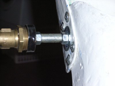

state of the shaft after towercrash
redressed shaft,bearings and bearinghousing
The normal and thrustbearing(need a spacer between),upper side of the shaft
The plumbingpart that was the nearly exact fit for the bearings
connection between shaft and threaded rod of the rotor
8kg weight on each foot
flying!

How did you make the blades?  I tried to look at your previous torkmaster post from June, but the pictures don't show up.
« Last Edit: July 26, 2006, 04:26:35 PM by Slingshot »
Stonebrain
  • Posts: 342
Re: torkmaster flying
« Reply #2 on: July 26, 2006, 04:37:35 PM »
That's because I deleted some of my files.
I shouldn't have done it.
I'm very sorry.
Will try to get them back,if that works.

 What do you think about moulding off the inner sections or is having them open part of your plan?

Look here how it was revealed to me:
http://www.fieldlines.com/story/2006/4/7/13354/21751
all pics are back.
Basicly it is to a savonius wat a H-rotor is to a darius:
a savonius without top-bearing.
Hope it will perform like a savonius.
cheers,
stonebrain
« Last Edit: July 27, 2006, 03:25:48 PM by Stonebrain »
Stonebrain
  • Posts: 342
« Reply #16 on: July 27, 2006, 03:48:43 PM »
What's happening in the innerpart is just guessing.
My idea is to keepit open to have a "crossflow" effect.
Just like any savonius.
my rule is to interfere with airflow only when you can
expect positive drag or lift.
What I should do is to build some rotors based
on the same principle but with some parameters of the
geometry varying and mesure performance.A hugh program.
