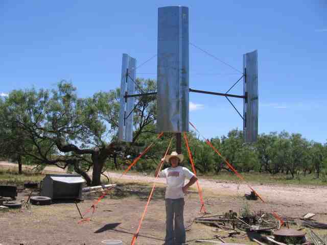

Just got this one back up and flying. It too is in the trees but what can you expect with an 11 ft test tower. <grin> 15 ft to the top of the blades and 7 ft off the ground for the bottom of the blades. It had the two 2x8 ft blades on 6 ft arms which ended up with too much vibration so it was taken down. I wasn't going to put those wings back up but go on to the sailwings. Everyone kept asking why I took it down and if I was going to put it back up. I needed to try and build a 3 wing style anyway to get the process figured out and it was easier than explaining why it wasn't flying.
Just a day or so ago I finished adding a third wing and putting it back up. It is flying nicely but just free spinning no load on it except for it's own mass. It sure is smooth with very little vibration its main problem is that I overbuilt it so it is too heavy. Spinning a turbine that is 8 ft tall x 13 ft wide with about 210 lbs of wing, arm and shaft mounts. It spins in a 1 mph wind unsure what it takes to start it it but not much as it is almost always spinning. It is slow to respond to wind gusts and relatively quick to slow when the wind drops. This is bad when the top of the blades are no higher than the tree tops. Hey I have short trees 15 to 20 ft tall. I do have the main direction that the wind is from free for about 200 yds or so and the trees aren't all that dense but they do make for turblent winds and gusty conditions.

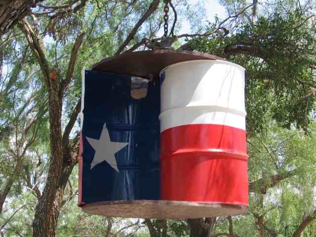

Best of luck and once you start back to building it is hard to stop. We have been sitting out drinking coffee watching it spin in the morning before the sun comes up. What the heck here is a few pics of my yard art. One is my Texas twister and the other is the flasher named for both the flashing it is made from and the fact that it flashes in sun light and in bright moon light.

Hello Finis
 Very good job there.
 This is an interesting experiment for wider diameters.What would your guesstimations be for rpms in a 15mph wind?
 Being slow to react to gusts isnt a bad thing im sure the wide diameter will slow the reaction.
 Have you tried to stop it yet or hasnt it seen much wind yet?
 Has far has the rotor weight goes,im thinkin the heavier the better has long has it doesnt create much drag, sorta flywheel effect.How are your bearings and is the rotor perfectly level?

I know it is a bad match but he doesn't want to make compressed air he wants something to pump water and something to look at. It is wastefulness at its peak as a bubble type waterpump is really poor on how well it pumps(I could rig a piston type but it isn't what the wants). The deal is his well water is so bad it needs aeration and it eats up pumps. I have an old compressor(motor and tank bad) that takes about a 1/2 hp motor but should work at any rpm and all that weight will work as a flywheel. He is just going to run it into a pond as he is on a rain water system now. His site has only fair wind as he is on the side of a hill. I am not committed to doing it but I want to find this set a home when I move on to the next set of blades and he helped put it up the first time.
I am still hoping to see a set blowup. The 2 blade setup went through some 35-45 winds with higher gusts unloaded remember it is in the trees. I only went near it to tighten guy lines as it made groans and creaks and tried to pull the pipe out of the ground but my set of blades seems to stall in higher winds at least unloaded. I have just enjoyed having a set that worked first time and will spin when the tree leaves don't even seem to move. 1 or 2 rpm but moving. The L/D ratio must be pretty close.

Best winds so far probably 7 or 8 with gusts to 12. It should have more torque with the extra wing surface than the 2 blade. The extra weight is a real drag as it eats power when trying to speed up and eats power as it trys to keep driving the blades when the wind slows. If I had a good steady wind flow it would work fair but with lots of turbulence and gusts it just doesn't work well.
It should be level as pipe was set and guyed with a level. The top cables help keep the blades square and add a lot of support. Bearings are pillow blocks new 1 1/8 I think whatever the shaft was. The keyed steel pulley that this is all kind of bolted to says it is too much weight thank goodness I have the top 1/4" thick plate setting on top of the shaft.
Yard art is fun and doesn't need to really be good for much except to look at. I saw one that was a US flag and wanted a Texas one and had the barrels up and spinning from a failed first try. I will add another layer with the grandkids hand and footprints next. My test blades fall into yard art too as they are really fun to watch but don't do much except give me some info.

Good luck on the new blades remember that it is how fast the blades move not how fast the shaft turns on the bigger diameter machines.

« Reply #16 on: October 29, 2006, 11:00:56 AM »
Now that's IMPRESSIVE!!!
I'm in Texas too, and would love to come take a look at that thing when my truck comes out of the shop. What part of TX are you in?
