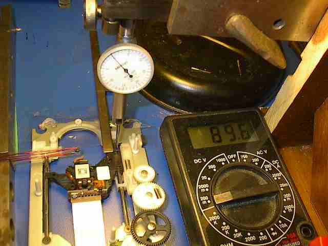

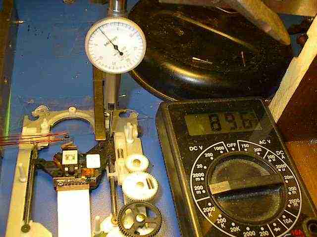

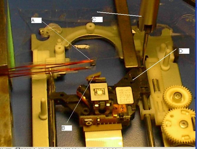

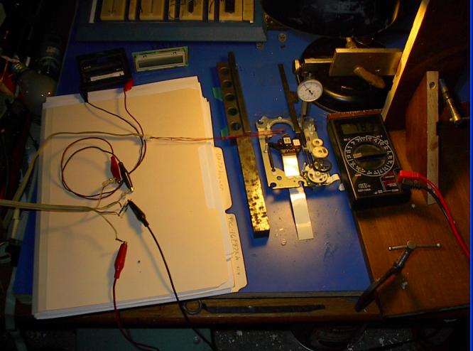

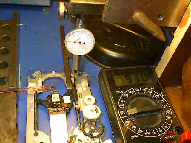

« Reply #12 on: August 24, 2006, 05:47:21 PM »
I did some repeatability testing
A) is the sensor
B) is a chunk of broken HD neo magnet
C)dial indicator
D)carriage from cd drive
this is a wide shot of the whole setup
next to the salvaged LCD readout is the "power" going to the sensor in the upper left. i left it connected to the sensor for days , by accident , and found the battery in good shape so i checked the current draw from the sensor , its only 4.6mA
and thats the most it draws , it actually goes down the closer the sensor is to a magnetic source. with it right next to the 1/2"dia mag it only draws 2.7mA strange..
those parallels next to the carriage hold the sensor wires
on top of the folders is my wacky wiring system the sensor wires are plugged into a cable just to hold them in place, it needs some work i suppose.
here is the millivolt reading with the dial indicator set at 0
here i moved it in 5 thousanths of an inch
here i moved it back , it didnt always come out exact , but was always within one or two tenths of a millivolt.
With one of my 1/2"x 1/2" dia magnets i could swing the voltage output up to .556V and down to .248V in a span of 1/2 inch.
« Last Edit: August 24, 2006, 05:47:21 PM by willib »

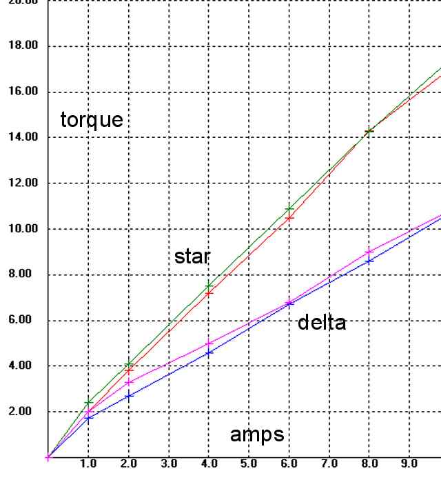

I assume you mean axial as most radial machines have iron.
I strongly suspect that with a star connected airgap alternator the torque will be proportional to dc load current near enough for normal use. This would simplify things quite a bit. I wouldn't expect this to hold for delta connection with circulating currents.
For an ac load into resistors the relationship should be pretty exact, I think I can set up and check the dc case fairly easily to see if the rectifiers do anything queer.
« Last Edit: August 26, 2006, 02:35:48 AM by Flux »

Within normal experimental error it seems as though dc load current is near enough to torque for an air gap machine. There is an offset at zero no doubt due to the diode drop and the torque is higher than indicated by amps into a battery compared to a short circuit, but results will be within the errors expected from a torque measuring circuit using cheap options.
The graphs show that delta is slightly worse than star but still within reason.
The low curve in each case is short circuit current. The higher one is into a simulated 12v battery ( constant 13V)
Don't expect any of this to hold for iron cored machines but for axials you have a simple method of measuring mechanical power.

Torque was measured direct with a spring balance just as you planned to do.
This is a direct comparison between true torque and dc stator current.
Ah.  Parasitic loads (air friction, eddy currents, etc.) are linear or near it and start as soon as the genny is turning.  But current through diodes starts after you've got 1.2 volts to overcome diode drop.  So: a kink at startup.  An offset that corresponds to the torque from all non-output-current sources at cutin speed.
If you project the slopes back to the Y axis the intersection gives you that parisitic cutin torque.  Notice that it's very small for star (which has only mechanical friction and the tiny eddy current heating from currents circulating within the wire diameter), much larger for delta (which also has the circulating harmonic current).  This give delta a pronounced kink, star almost none.
Delta has a lower slope than star because with star all the load current goes through two coils, producing two units of drag, while with delta about 2/3 of the load current only goes through one coil, producing only one unit of drag for that fraction.  Resulting slope for delta is about (2 * 1/3 + 1 * 2/3) / (2 * 1) = 2/3 that of star, which is about what the graph shows.
I expect delta to show a little deviation from linearity along the curve, falling off a tad at the right, because heating of the coils reduces the circulating current's parasitic load to something below what its linear-with-speed projection would predict.  But the harmonic current in this machine is low enough, and the temperature-related resistance change small enough, that it doesn't show up.
Since parasitic loads are proportional to speed and speed is higher for a given current when charging batteries than when shorted you get a higher torque for a given output current for chargng than for short.  But since parasitic loads are a very small fraction the deviation is small, nearly in the noise.  And it's higher for delta.

Your torque measurements are Kg-m ?
i dissagree with the statement "The graphs show that delta is slightly worse than star..."
because at 4 Amps star used 7 to 7.5 ? kg-m of torque , while delta only took 4.5 to 5 kg-m of torque to output the same amount of current?
there may have been other factors like RPM , to make you say delta was worse than star , but from here it looks like delta was more efficient than star , in that for the same current delta put less torque on the stator , and ultimatly would use less torque from the blades ?
« Last Edit: August 27, 2006, 11:24:03 PM by willib »
Re: Force measurement with hall sensor
« Reply #32 on: August 28, 2006, 12:43:52 AM »
This was a test to determine the relationship between dc current and torque.
It has nothing to do with power or speed. When I say that delta was worse than star I was just referring to the linearity of the relationship and the fact that with delta the difference between short circuit current and current into a battery were greater.
Obviously the star winding will produce more amps into a short or into a battery at lower speed and will take more torque to produce the same power.
I gave you no speed readings so you have no way of knowing about anything other than torque, You can form no opinion on power or efficiency.
The delta speeds were higher in each case, the short circuit figures were at a crawl and the 12v figures were around 150 rpm for star and 300 rpm for delta, changing with current to some extent.
Did I confuse you when I said this gives an easy way to measure power, by that I meant that you could derive torque from dc current and use the speed from frequency to have the 2 components to measure power.
