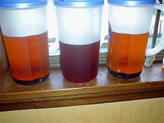

`Hi Bruce, this is the way that I do it. Mixing 5gal. At the time. Use a large pot to heat the batch to approx. 120F cook for a few minutes to boil off any water that is in oil, remove heat and let stand until the oil cools to around 60F. While the oil is cooling, mix twenty teaspoons(1 cup plus 4 teaspoons of red devil lye and twenty cups (one gal. Plus one qt.) Methanol in a large bucket . I use a drill motor and paint stirrer, and mix until lye crystals are dissolved (PLEASE WEAR PROTRECTIVE GEAR) add mixture to oil and stir for about five minutes.  Let stand for a short time and you should see the mixture start to change color and start to separate. If progress does not suit you or you get impatient stir the mixture again, unnecessary but it gives you something to do. After another few minutes of settling you should see a marked change in color. Leave overnight without disturbing oil. Stipend off good oil and leave fatty mess in bottom of pot( this mess makes good fertilizer if mixed with compost) add fresh water to oil for first wash,  about a gal. And mix well and let stand until oil rises above water, I waited overnight, separate and repeat final wash. Final process is drying and I use a small air pump to aerate the oil for several hours and let the batch set in an open container for a while and then  heat the biodiesel in the original cooking pot about 100F to insure that all water is gone, ready to use. Cost of methanol is 3.50 gal. (Racing fuel) about 1.50 per gal. If you buy 50 gal drum from chemical supply, 2.00 for box of lye.  About a buck a gal for biodiesel. Have ordered fifty gal drum of methanol so after I use up the ten gal. Of methanol I have on hand I should have the cost down to about forty cents per gal. NOTE: making the next batch without washing to test another method of production. Will let you know how it works .Formula for one qt. Used cooking oil, one cup methanol ( heet brand fuel additive) one level teaspoon lye hope this helps, pepa.
« Last Edit: August 30, 2006, 06:51:09 PM by pepa »

i see no mention in this of doing a titration to make sure you add the correct amount of meth/hydroxide? also- you should stir occasionally during the initial heating to make sure you dont get any water pockets on the bottom that boil and blow steam/hot oil all over. that particular preheat wastes a fair bit of power, and can be done via solar  or cogen heat...

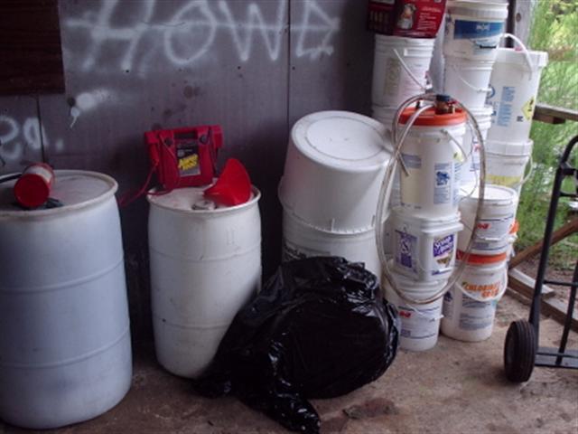

Allen thanks for your comment, i am blessed with a large supply of clean used cooking oil and only keep the best of it to work with. i heat and seperate by settling without chemicals, the best of the oil which i store in large containers . without any further work the oil will continue to seperate from the foreign matter that collects at the bottom. when i started the process of making biodiesel i did tirating oil test on several different batches and the results were identical. the lye is to seperate the water from the oil and a simple test is to add a small amount of lye crystals to the top of a cup of used vegy oil and stir lighty, let stand for a moment and if the oil has very much water in it the lye will float to the top as a gel type mess. of all the formulas i have read about there is very little change in the amount of lye if the oil starts without a lot of water in it. i am new to biodiesel making and so far what i have done has worked well for me and my petter likes it to. i drained out the fuel tank and put in five gals. of this stuff and have run it for about three hours so far on B100 and the engine operates the same as with regular diesel, shut down and cranked quiet a few times ( this is a test before i use the biodiesel in my big chevydullie) one thing i did notice, on cranking, the petter does not blow black smoke out the pipe as the diesel did and my son said that it smelled like french frys. i will be preheating untreated oil for free (to many irons in the fire at onse) when i get the oil burner finished. pepa
