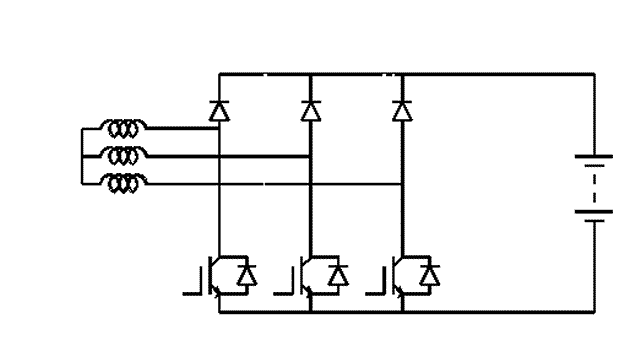

Just a bit of an update.
Some time ago I posted a circuit using the alternator winding inductance as part of a boost converter. At that time I suspected that airgap alternators did not have enough inductance to make this work.
I was wrong and they do have enough to make it work at a few kHz. This method does have one advantage over the scheme I showed before, the diode drop is inside the boost voltage and has less effect.
This is the basic scheme.
The active thing is a mosfet, sorry for the IGBT symbol but is easier to draw.
The series diode drop can be got rid of by using 3 mosfets in the bridge.
The 3 mosfet gates are driven together.
I tried this at about 5kHz and it works quite well. The machine squeals and it is fairlylikely that there is losses induced into the magnets but efficiency is quite good.
Having perhaps 100yds of cables radiating is not a particulary nice concept but would not matter if you have no near neighbours and don't listen to medium wave radio.

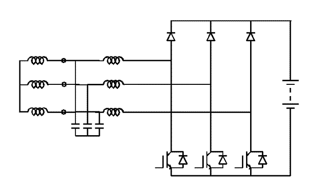

I wasn't prepared to persue things in this form so I looked at filtering the leads at the converter and adding small ferrite inductors, the inductance required at 30kHz is tiny, 200uH or so. The inductors can be a few turns round ferrite cores and cost little and can be made to cause negligible loss.
This is the set up.
Filter capacitors are about 10uF motor run capacitors.
This is about as simple as it comes. A pwm driver with current feedback is used to control mosfet gates.
I did this some time ago and more things need investigating but I haven't got round to it.
The diodes need to be fast. Normal fast diodes seem to have a very high volt drop but come in sensible packages.
Ultrafast diodes are better and for the 24v case you are still within the range of schottky. The thing that I don't like is the fact that these animals come in very uninspiring packages mainly TO220.
There is no problem within the range where boost is taking place but in higher winds the full machine current uses this bridge, mosfets using their body diode.
Up to about 40A this looks to be possible but I would be reluctant to take it much higher.
Decent package mosfets and schottkys come at a stupid price.
I have thought of ways to transfer part of the current to a robust diode bridge when out of boost but I haven't tried it.
I will leave it with you for now to think about until I have checked a few more things.

Won't "ringing" the coils with a chopper (so to speak) make them have a much higher currant peak then normal?
Especially near normal cut in?
And slapping more/less square wave demand across the same genny coils raise hob with the normal ebb and flow of the, again,  more/less sine wave pattern?
Looks like it may produce a bit of growl in the genny too, if using the coils for the inductance.
But the caps may have an additional bonux if designed just right outside of helping with the growl/load seen by the genny (and filtering)--capacitor improvement for the power factor. But then again--the PF is all over the place anyway using wind for the driver source.

I think you could improve on the losses by replacing the diodes with FET switches also, driven synchronously with the others but out of phase. May need some dead time.
I'm a bit confused since you say you tested at 5kHz, but when talking about the filter inductors, you mention 30kHz.
I think that, perhaps, the addition of the capacitors will somewhat negate the stator inductance and the boost is happening from the added inductors. If around 200uH, they should be well above minimum to keep them in continous mode at 30kHz. Of course, they would be subjected to core loss and saturation issues. I still want to try large air-core inductors here.
Have you looked at any waveforms yet?
I'm sure you're aware that twisting the transmission lines will tend to minimize radiation.

Sorry I should have made the frequency thing clear.
I did the original tests at 5k, the alternator squealed so there is significant HF field induced in the surface(most likely plating) of the magnets. It will work well enough in that mode if you don't mind the noise. I pushed the frequency up and it still worked without the noise but it was messing up my frequency measuring equipment and it seemed unreasonable to pursue things in this form. The RF radiation would not be acceptable for a lot of people.
Having seen advantages from the inductors before the bridge, I decided to ignore the alternator inductance, add the filters and add ferrite inductors to replace the winding inductance. This removes any possible surface induced loss in the magnets and keeps the feed cables clean.
I used about 30kHz as a compromise between inductor size, filter efficiency and the layout problems.
If anyone wants to try it in the basic form I think at 5kHz it may be possible with standard diodes but the fets will need a good voltage rating or snubbers.
You can almost certainly get away with air cored inductors if you find they have some virtue that I don't follow. If you seriously reduce the inductor size things changes as you go into discontinuous conduction.
The thing changes to a form of high quality boost rectifier and the discontinuous chopped lumps of current more or less follow the input voltage waveform. The dc current becomes much less distorted. I had hoped that this would benefit alternator efficiency as they really don't like rectifier loads. In fact I saw no improvement in overall efficiency and didn't chase this mode. The inductance with the yoke removed from my cores may have been about 50uH.
If you are stuck with 12v then synchronus rectification may be justified. I tried the scheme at 12v and it was efficient enough to be usable but at 24v the efficiency is good enough not to add this complexity.

Capacitors can have a significant effect across the output of a motor conversion, where it influences the armature reaction and the leakage reactance and is often beneficial to output, especially series capacitors.
With air gap machines,both armature reaction and leakage reactance are very low and capacitors have negligible effect. It was this very low leakage reactance that made me think that the scheme might not work with air gap machines. Normally it is leakage reactance that is the important factor. For this boost it seems as though winding inductance is the factor, not the leakage component.
The peak current is not an issue as the boost is at low power when the alternator is producing a fraction of its full output. It does growl (at 5k more of a squeal).

However, one thing. You know that the fast turning on/off of power to/from the windings puts an extra strain on the coils? It's the reason that induction motors that are to be used with a Variable Frequency Drive (frequency control) use wire with extra strong insulation. These motors are also known as 'inverter rated', IIRC. Normal motors are intended to be used with sinusoid-AC, which is much more 'gentle' to the motorwindings.
Using this scheme with coils that use a low insulation rating could lead to problems, over time.

flux i dont see it..
in all but the first example ,
the current in the fets is not going from  drain to source ?
sorry to through a monkey wrench in the works , but ...
if i'm wrong , i apologize in advance
« Last Edit: October 02, 2006, 08:58:51 AM by willib »
Re: Load Matching
« Reply #6 on: October 02, 2006, 09:38:16 AM »
In boost mode the volts are not high enough for the bridge diodes to conduct to battery. You have three wires with voltages on them at any instant and you short the lot together with fets. The positive ones will conduct in the conventional way. Those negative would conduct via the body diode but as all fets are gated they will actually conduct through the fet in the third quadrant. When you remove gate signal the conduction to the battery is via at least one bridge diode and a mosfet body diode.
You can amuse yourself for some time sorting out the various conduction paths but it really is nothing more than a modified  boost converter.

"You can almost certainly get away with air cored inductors if you find they have some virtue that I don't follow. If you seriously reduce the inductor size things changes as you go into discontinuous conduction."
The thought behind use of air core inductors is two fold. One, to eliminate core loss and saturation issues at high current levels and second, the lack of suitable cores in my junk box.
I'm not thrilled by the idea of having to wind #4 or #6 around cores to get the resistance down.
As I see it, the main benefit in using ferrite is to reduce the physical size. If size isn't an issue, 3-4" diameter air core inductors are easy. I'm still not sure about the trade-off of increased wire length for a given inductance and resistance.
Any thoughts?

« Reply #8 on: October 07, 2006, 01:08:51 AM »
You will almost certainly get a higher Q with ferrite cores, but for the inductance values needed air core most likely will be good enough.
Not having ferrites is the best argument against them. Core loss will be very small.
Saturation is not really an issue at higher current levels as the fets will not be chopping except at low current in the boost mode.
Wire should be litz or multi stranded and will be no problem to wind. Even with air cored coils you should be thinking about litz. Harmonics of the chop frequency will be up in the low RF range and eddy loss and skin effect in solid wire will make the coils poor ( may still be good enough, I don't think it is very demanding).
Tape wound copper coils may be good enough if the tape is fairly thin.
