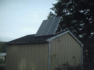

Living out a little ways, we frequently have power outages do to winter storms, for the most part this is not a nuance, we heat with wood for the most part, and kerosene and candles take care of the lighting needs. The most frustrating part is not having water, I keep ~30 gallons or more in gallon jugs for this reason. My wife wanted to do something to have running water for these occasions.
I came up with the following solution:
  • HarborFreight 45w panel (on sale + 15% coupon)
  • 12v deep cycle RV battery
  • 12v RV water pump
  • Two 55g drums
  • Misc. plumbing and wiring
This provides us with backup water during power outages, the flow is limited but you can wash hands, cook and flush the toilets that should make everyone a little happier.
This year is phase one as described above, there are some limitations as in the system does not start on it's own, (flip the switch and open the valve) and the tanks are manually refilled with a hose from the hose bib in the pump house (the same one that the 12v pump is attached to).
Next year I plan to add couple more 55g drums and automate the refill with a trickle fill through a Hudson valve or similar to keep the tanks from over filling. In addition, I plan to hard plumb the 12v pump into the system, and possibly add a relay to engage the system when the grid power is out.
Next weekend I hope to get a couple of photos of the system.
I have a question how sturdy are the HF racks for the solar panels? They are mounted to the roof of the pump house, so the panels have a steep slope my concern is wind and snow load, the panels are not supported above the mid point, and the attachment to the rack is not that secure in my view. Does anyone have any suggestions?

Re: One small step...
« Reply #1 on: October 31, 2006, 04:08:25 PM »
James;
    The HF , the very same you have does indeed seem very flimsy. I therefore only used it for initial setup the "test" the system.
The angle I watched while a hard rain hit during the first rian out of the world series, It didn't have a problem with the rain but they did wiggle in the 30mph winds. I fixed that prblem by using a 2ea on each panel the smallest wall close hooks, some havey duty picture wire and a turn-buckle on each. These I anchored and turned them just past the point of being tight. No seeable movement this past Monday OCT 30th when the 20-30mphs winds came through.
The angle to me is steep enough and the with the glass and Aluminimum will heat the snow up to not have a worry with snow.
I'm St. Louis,Mo so you're snow depths my be different than mine. I will keep an eye out them throughout this winter.
Hope this helps.
Bruce S.
PS, I used membrane selant for the anchors, don't need any leaks:--)

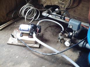

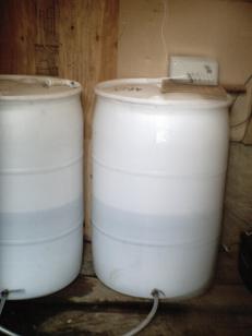

Pictures Finally
The pump house with the HF solar array on the roof, sorry cloudy day, it's the pacific northwest after all.
Here are the water tanks and the charge controller and battery in the pump house.
The pump is hooked up to a hose bib in the pump house temporarily.
--James.
« Reply #14 on: December 01, 2006, 01:48:55 PM »
Hi James,
Why all the extra wire?
It can't be good to leave it, if it is connected.  I can't quite tell.
« Last Edit: December 01, 2006, 01:48:55 PM by ghurd »
tjspears
  • Posts: 23
« Reply #15 on: December 01, 2006, 02:23:41 PM »
The coil of white wire is the 120 for the submersible pump. When the pump house was put in, I replaced existing doghouse over the wellhead, but left the pump control box by the wellhead. When I replaced the doghouse and installed the backup water system, I moved the control box in to the pump house recently but not cleaned up the wiring yet.
--James.
