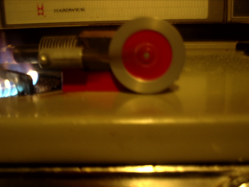

had this little engine for a few years--cant seem to get it to start up ..
any ideas?
all it has on it is---phoenix arizona  solar engines--
  it has a screw on the smaller cylender--air screw-?
  and a wick on the underside of the big cylender that burns white gas or alcohol..
  fired up the wick--but no go..
  cant seem to find anything about it on google--just a picture of it..
  no idea when it was built..50s 60s just a guess....

tried all kinds of tricks to fire it up--cleaned up real good -oiled it--even a propane torch for a short time..
spins over easy enough--slight back pressure..not much wear and tear on it--hmm ???
« Last Edit: December 09, 2006, 01:40:27 AM by hiker »

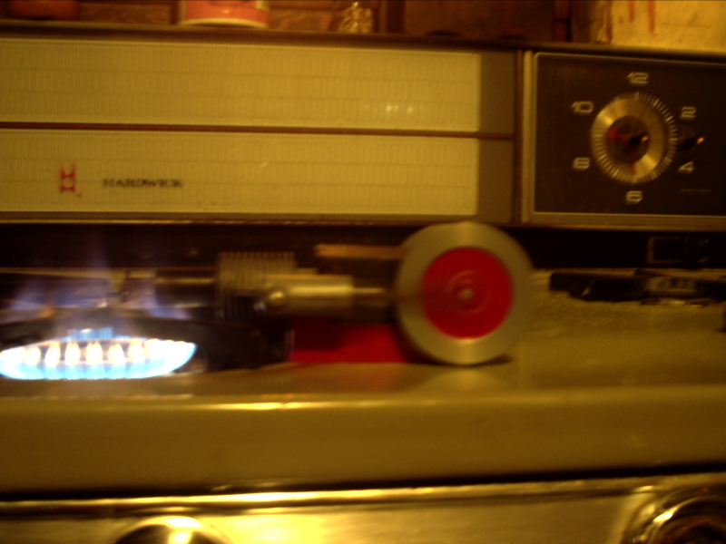

Re: solar engine
« Reply #5 on: December 09, 2006, 04:54:41 AM »
tore the head off the engine and found a small amount of rust--cleaned it up and oiled  it all down..the piston doesnt really ride on that top portion of the head that i cleaned--theres a small gap--i guess so the hot air can go around--the last time i tore it apart i noticed that and didnt think that small amount of rust would matter..i guess it slowed the air down and kept the engine from turning over...
 took the motor from its base and put it next to one of the burners on the stove--with a little help it fired right up--spins over really nice now................ :}

Re: solar engine
« Reply #11 on: December 10, 2006, 04:45:22 AM »
it is a nice running little engine...surprized me after laying around all these years..
it does take a few turns my hand to get it going thou...then it really takes off..
no hot air is sucked into the engine...it has a heat tube at the top of the cylender..
 not sure how it works sence its a closed air system--must move the air back and forth between the two cylenders--heating and cooling--or expanding and then contracting...
  cool little motor---just somthing i found at a thrift shop a few years back..
« Last Edit: December 10, 2006, 04:45:22 AM by hiker »

« Reply #14 on: December 11, 2006, 06:38:41 PM »
It's a sterling.
The piston in the cylinder with the fins and flame-applied-to-the-tip is the "displacer piston".  Gas goes through the clearance between it and the cylinder wall as it cycles, to push it to the hot side to make it expand and the cold side to make it contract.  The other piston is the "power piston", which uses the pressure changes from the expanding and contracting gas to push and pull the crank.
Rust in the displacer's cylinder would provide friction to slow things down and make it hard to start (or even keep it from running).  The displacer needs to move freely.
You need good (REALLY good) seals in two places:
 - Where the displacer piston shaft leaves the cylinder.
 - Where the power piston rubs on its cylinder.
