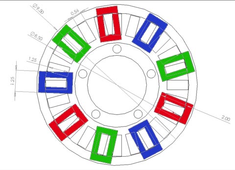

i got it done.
its mounted to the stator support plate.
i should have taken shots of it during construction ,but i have to dissassemble it again so i will take photos
here i have the hub(head) inverted , amazeingly there were holes , just the right size to tap , to mount the adapter plate to
it spins like silk
as you can see in the first shot i've also got a new blade in the works
