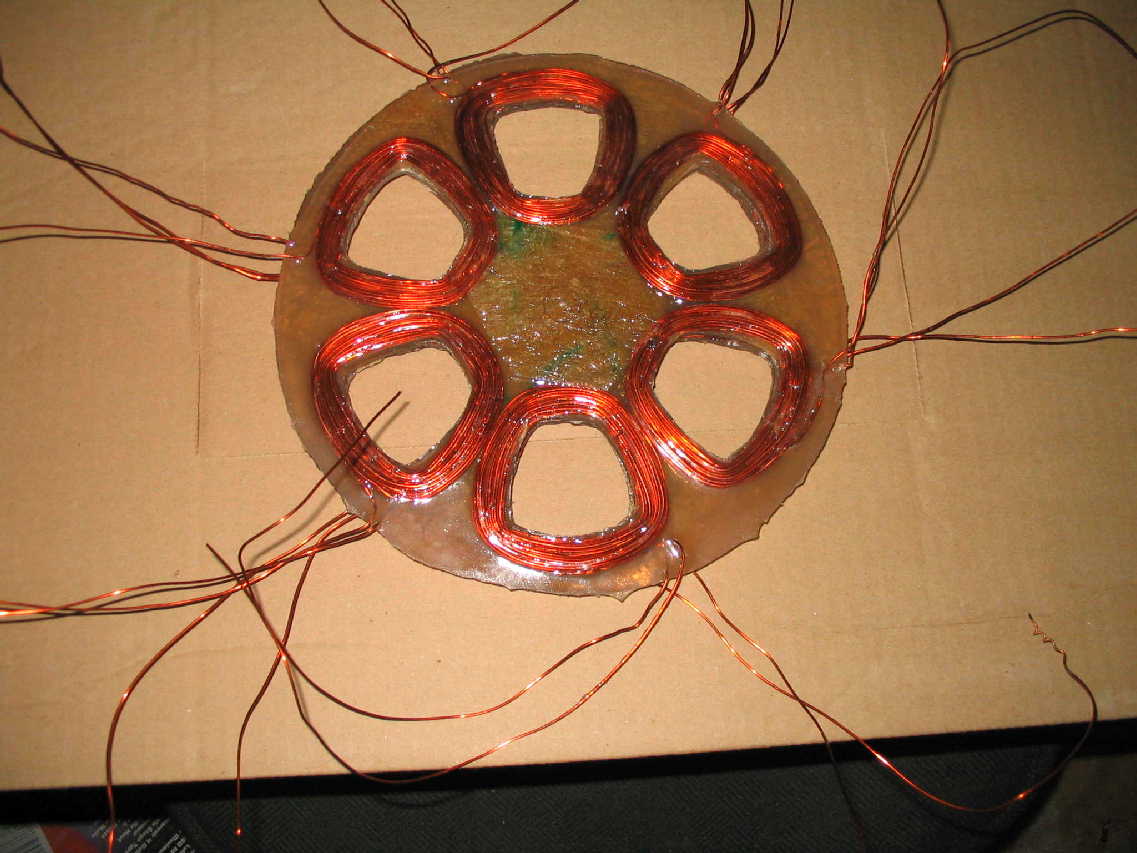

I don't know if this will pan out but the coils are working so far .It will take some time to get the hardware jigged up for test . I can use some old 7 1/2 rotors . Sorry about the brevity but If someone has some data here chip in.

hey tecker
  looks like a 8 and 6 combo with twin stators...
  try some sawblades for rotors-double up..

 First up is 8/6 Three phase Two rotors no studs and maybe some steel between. I'll get the jig up soon .

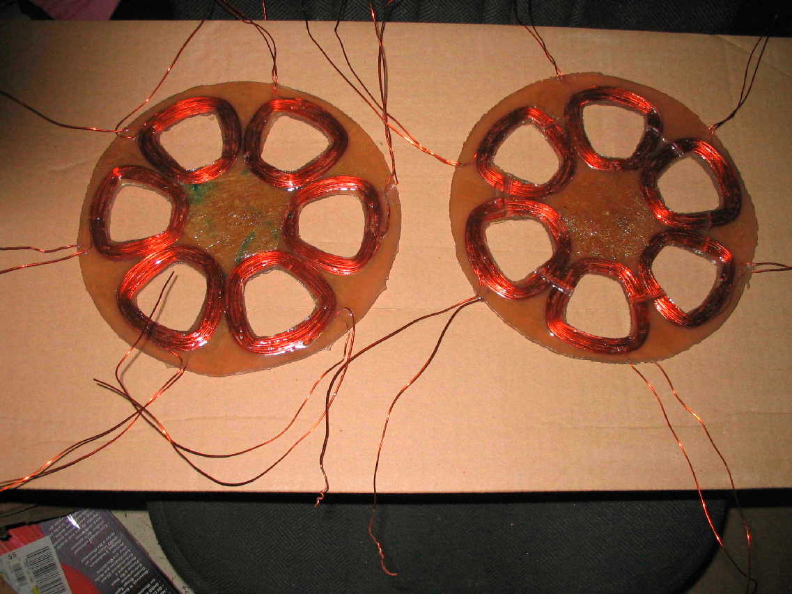

Tecker i would stack them and if they are identical , they look it , the options for wireing them up are many.
You have all the individual coil leads available so, if you orient the coils directly on top of each other you could wire the coils in series if you need to ,
example: coil 1 start would either be connected to the alt output or connected to the star point.
coil 1 end would be connected to the other layer coil 1 start , and the other layer coil one end would be connected to the next one in the phase
or you could wire them in parallel and rectify each stator seperatly for double the current , but i fear that since there is so few of them , just two per phase  that you may make out better by connecting them in series
a word of caution , if you happen to get the coils backwards the will cancel each other out so it may be best to start one phsae at a time , rectify it and test it , and dont make any connections perminent till you are satified :)

The object really is to go smaller by offsetting 10 to 15 degrees to see If I can get more power with a wider leg . I got a good look at it with two coils and it looks promising
