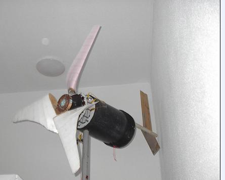

I think its about ready to fly!
it starts charging a 12V batt at about 220 rpm , and the blades will go 220 to 280 RPM in a 7mph wind , lightly loaded , so this next test is not only for the alt but for the blades also.
very soon i will have more data on its performance.

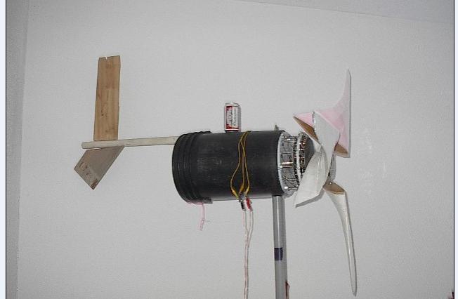

Sorry to be so brief in the origional post.
i believe this gen will kick a** !
Time will tell i suppose
Yes thats a plastic garbage pail, yes the rotors are cut from cast iron frying pans , yes thats a recycled vcr head for a hub
to recap it qualities ,
it is a 16 pole dual rotor Three phase with thirty two 7/8"dia by 1/2" neos
12 coils ( 4 per phase)
each coil weighs around 55g ( some a little more some , a little less)and has around 78 turns of 0.045" dia wire.
the coils are a little less than 1.75" dia , with a 0.46" hole , which by the way is the distance between magnets
stay tuned , the future looks bright , i've got a larger one in the works , not so mini

willib;
Yeha! gotta love using what is around.
How did you cut the rotors from the pans?
What capacity is the garbage pail? Hard to get a feel for the scale. The pail looks like a longer than normal 5 gallon bucket but that would make the unit bigger than it seems to imply in your other comments?

« Reply #3 on: January 29, 2007, 07:19:58 PM »
oh, duh.
Finally recognized the beer can for what it is.
« Last Edit: January 29, 2007, 07:19:58 PM by TomW »
Re: Minigen update
« Reply #4 on: January 29, 2007, 07:30:56 PM »
hey tom !
yes the pail IS a longer than normal 5gal bucket ,it origionally said xxx Township Recycleables , and something about " under penalty of law .. .." but the owner gave me two , lol
as for the iron skillets , first i drilled a hole in the pan then i used a hack saw to cut the center out, following the outline on the pan.
« Last Edit: January 29, 2007, 07:30:56 PM by willib »
Re: Minigen update
« Reply #5 on: January 29, 2007, 09:58:46 PM »
almost forgot ...
the blade hub is/was two 5.25" hard drive plattens with blue foam inside
things i bought are
the mags
the skillets
and the stainless nuts and bolts
the foam for the blades
everything else i scavanged.
the tail is a plastic pipe with cedar shingles
the bucket
the vcr head
the white plastic stator mount
the wire , all free!
oh yeah the wire connectors , i bought them too
and no lathe was used.
but i do have a craftsman drill press that takes my Ryobi portable hand drill and holds it sort of verticle :)
the Ryobi i got from a garage sale $1 i thought that was a bargan
the drill press was also from a garage sale that was expensive $10.

Willib, I see one of the blades is kinda pink around the edges. Is that just the lighting? What are you going to do for a yaw bearing?
I have not been able to work on anything last couple of weeks. Winter slows everything down here. Just have to stay alive is fun. Glad to see it coming together.
Joseph.
« Last Edit: January 30, 2007, 12:58:17 PM by WXYZCIENCE »
Re: Minigen update
« Reply #9 on: January 30, 2007, 04:04:02 PM »
it is pink ,i used the pink foam on that one.
i took the minigen out for a spin this evening, my toes are still froze i think.
anyway no hard data , but i did see it go to 2.3A into a 12V SLA battery at a wind speed that was high 7 and just touched 8 mph for a second.
it wasnt very windy at all ! Damn
there were some  people on the hill i use to test my gens , they were slegh riding on our first real snow ,two days old and hasnt melted , we didnt get much snow , about two inches is all thats left.
the hill overlooks the highway and is well above the treeline , in all directions , its a great place for testing.
« Last Edit: January 30, 2007, 04:04:02 PM by willib »
