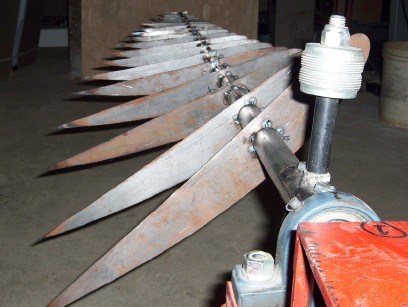

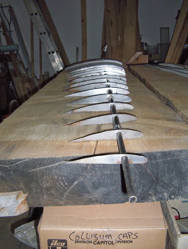

The airfoils were cut to shape using sheet metal
NACA 4412 with the program Profili 1.2
I welded the spars together using tube sections from 1 1/2" OD at the root to 1/2"
at the tip.
Then I drilled the airfoil pcs. 30% from the leading edge.
In this picture the airfoil pcs. have been placed on the spars to be welded
at the appropriate angles.
The next job after welding these will be foaming between the foils with
polyurethane foam insulation.
Then glassing them with epoxy.
It has an active pitch rotor, thats what the weight is for in the spar picture.
Thats about it for now.
Marv.

Willib,  It's 21" dia. and I ended up using #16 wire.
I used 18 stations so the distance between stations would be less,
to cut down the span for the foam.
Marv.

Quick question, are you building this blade (plug?) for mold making purposes, or are you using that for the actual blade?  I've seen it done like this before, (warlock.com.au) and it seemed to work, but I don't know if I would necessarily recommend it (I don't think I would even recommend it for making the plug, I have tried it once).  I can only imagine there would be balancing issues with trying to get precisely the same amount of glass and resin to make the same shape without molds.  I would also be afraid of delamination issues on the trailing edge, having those pieces of steel in the final blade.  Plus if you make molds for the shell, you can add the expanding foam last, and vary it slightly between each blade to help the final balancing.
What kind glasses, and how many layers (mils total)  were you planning on using for the skin, and for the spar caps?  What kind of root buildup/reenforcement were you planning?  What is the max/min chord and twist for this blade?  And this is for a 10' blade?

« Reply #6 on: February 15, 2007, 05:27:43 PM »
willib,  the root is 25 inches, not 25cm.
don't let that big timber it's sitting on fool ya.
here is a pic of one spar welded up. I got all three done today.
