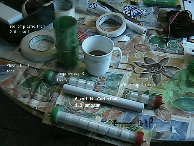

  Well since I drink pop that has a red cap and
wife drinks pop that has a green cap......
This works out pretty well, I took a short section of plastic shower curtain rod cover,
( the pink pieces) stick one into one of the caps, a little hot glue to fill in the gap.
  Took some small round head bolts,drilled a hole
in the cap, wrap a rubber band around the whole
works and thats it.
  Now I can charge each 6volt pak with stepper
motors...small solar cell....pedal power generator or whatever....
                Fun !
              ( :>) Norm.

Re: Bottle caps for Ni-Cad my 6volt batt paks
« Reply #6 on: March 08, 2007, 04:44:31 PM »
Hey that's a great Idea, I never thought about bottle caps.
I'm not sure if I posted it or not, told Bruce and Ghurd about my PVC battery sticks for the Ni-cad cells, may have posted it?
I take a PVC pipe that the batteries slide into nicely (Stuff I had laying around) and put a cap on both ends. I round a screw or bolt end so that it's smooth and won't cut a hole in a battery.
Drill hole in center of PVC caps to screw in the screws or bolts, fill stick with cells, press on the caps. Tighten the screws just enough to hold all the batteries tight together and to make good contact.
 A battery stick!
Adjustable voltage, just cut the PVC pipe sections to different lengths to fit more or less batteries. Use the section length you need for the amount of cells you need for the volts you want.
 If you have a good spring like used in the base of flashlights you can use that for tension to hold the batteries togther.
Normally I do not fasten the cap onto the pipe, press them on and pull them off, they seem to fit great normally and hold tight. When I do have a loose one, I drill a small hole for a little set screw in the cap, press cap on pipe and tighten the screw a little.
I found this to be a great fast way to make DC power packs, it should work the same with any round batteries using the correct ID pipe, AA, C, D, but I use it for Ni-Cad Cells.
 Keep a few caps made up and around handy ready to snap on pipe, then just cut the pipe to fit the batteries needed. Need 3V or 6V for a radio or CD player or 12V for a fan, just snip off some pipe and load cells then cap.
« Reply #7 on: March 08, 2007, 06:48:12 PM »
Well this last batch I got was 3 sticks in series
each 'stick' contained 5cells= 6volts 3 sticks
in series made an 18 volt pak.
I sawed the necks off of the 2 liter bottles
then reamed the necks just enough so they slip
very....tightly onto the ends of the batteries
both ends then screw the bottle caps on ....
I really like the colorful red and green bottle
caps positive and negative.
..12volt mostly to run small inverters.
..12volt fluorescent tubes ....etc.
       Just no end to the fun !
              ( :>) Norm
« Last Edit: March 08, 2007, 06:48:12 PM by Norm »

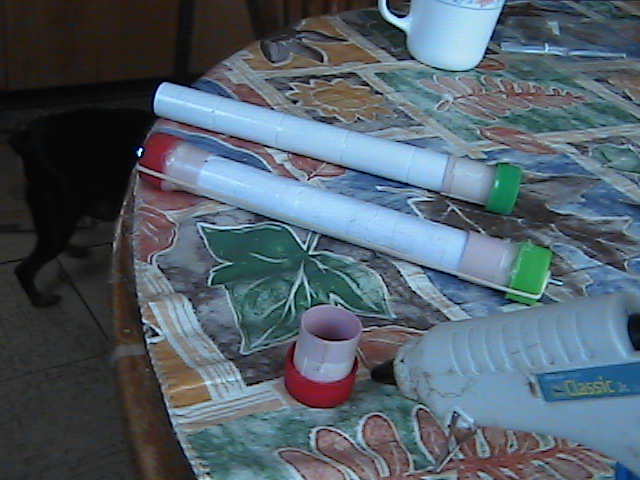

6volt batt paks modified
« Reply #21 on: March 10, 2007, 11:42:53 AM »
I've modified these making use of more of the
bottle......
 this saves the cost of pvc pipe.....
wrapped plastic around the stick wrap a couple
of rubber bands around temporarily then wrap
banding tape....makes a nice snug fit....put
the plastic tubes in end caps and hot glue....
Sleeve and caps slide right over the ends of the
'stick'...very snugly!
                  Fun !
                 ( :>) Norm

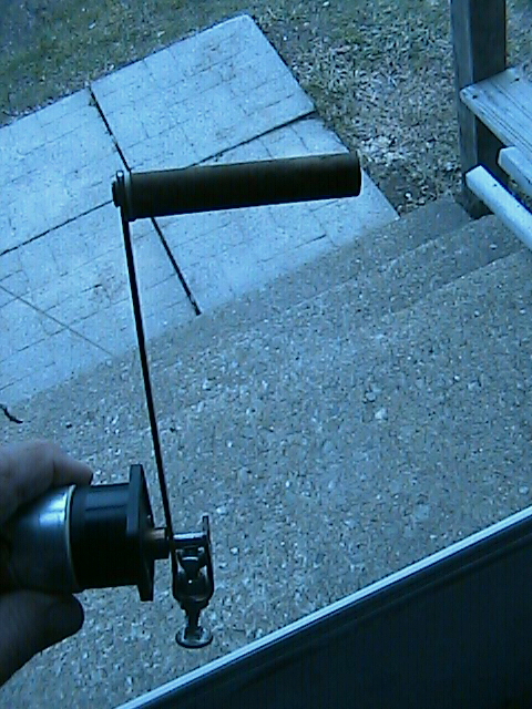

Thanks very much for the Ni-Cads Bruce
Your little motor does a dandy job  of
handcrank charging  these while I'm watching
my little TV....they can run the inverter
while I'm charging another set.
« Last Edit: March 10, 2007, 11:42:53 AM by Norm »

Re: 6volt batt paks modified
« Reply #24 on: March 12, 2007, 06:59:29 AM »
Norm;
  Wasn't able to get back with anyone 'til today.
Got a picture of that hand crank? did you take the 200:1 part off and make it easier? or leave it on adn build up a crank to fit on the gears?
« Reply #29 on: March 12, 2007, 03:52:59 PM »
Bruce,
   Here is the crank....looks flimsy but I plam
on making a heavier one in the future I was in
a hurry and anxious to see how well it (the
generator worked.....
next plan...an extended 1 inch 4inch long shaft
,so I can wrap a small rope around see how many
foot pounds per second to put out x milliamps.
« Last Edit: March 12, 2007, 03:52:59 PM by Norm »

Using Norms or my type Battery sticks you can make as many holders as you want for 6V charging size to hold the correct number of cell single cells.
Then make more sticks to hold those single cells to add up to your 16V needed. Dump out the cells when low from the laptop sticks and replace with charged cells. Stick the low cells in the 6V sticks to recharge them. Make as many sticks as you need, series the 16V sticks for the amps you need for the laptop.
 May not be great for using on a airplane, but if you use the lappy around home it may work well since you can sit or mount the sticks in any convienet location where you most use the lappy.
I'm not up on laptops so can't give much advice on those or the batteries for them.
 To recharge the laptop battery at 16V you may be able to rig something up, like charge single cells at 6V, series 3 sticks for 18V, dump those to the laptop battery. But check  with others for best way to do this, I don't want to give advice that fries an expensive laptop battery!
If you have a 12V adapter to use the laptop in your car and able to recharge the battery from the car, can you wire some 6V sticks for 12V then connect to the 12V adapter?? Just a thought.
As for the PVC pipe, look around for scrap used sections or check construction sites for free cutoffs, maybe check with the shops/stores that cut the pipe for people.
 I get free Plexy at times in odd sizes or shapes (broke) from an ACE Hardware, cutoffs they don't want. When I am at the store anyway I might as well ask for free stuff I might use later. You might find shorter PVC sections that way free.
I already had the correct sized PVC in long full lengths, bought a bunch at an auction years ago for a couple bucks, very cheap! I never used it for anything till I got Bruce packs. I forget what endcaps cost me, a few cents each?
 You could use other things than caps, just I found it fast, easy, and cheap, but many other ways. Maybe bore a hole in a piece of scrap wood for a tight fit and make your own caps.
