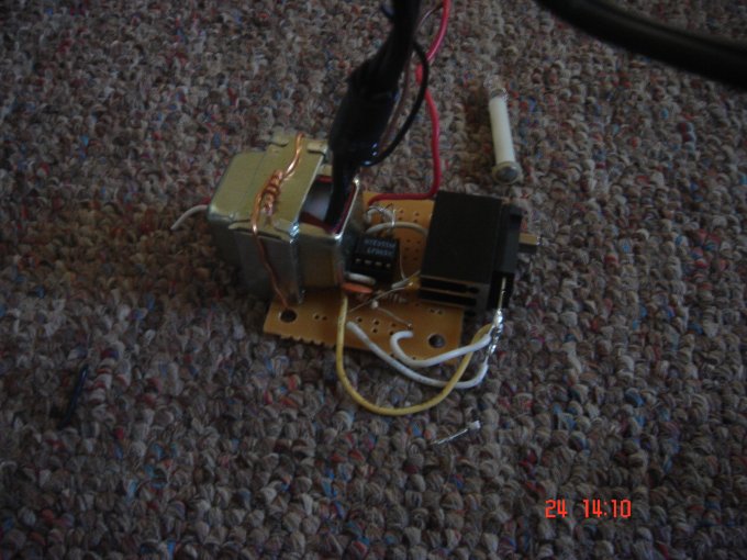

« on: March 25, 2007, 02:45:48 AM »
This driver circuit was made from random stuff that I found rolling on the floor. I only bought the case in Rat-a-Shak for 3 BUCKS! (expensive for the size.
it uses the following components:
555 Timer
5 Resistors
2 ceramic disk capacitors
a power MOSFET IRFP150N (you can change this one with a more common one like the IRF540)
a transformer that I striped from wife's clock/radio/alarm   :-P
Check the pictures out:

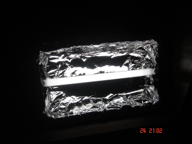

This reflector I made it with "Chuck Tender Steak" packaging. It might not have the perfect shape but it was easy to make with since I could do all the cuts with a kitchen knife. I used a little bit of aluminum foil with the shiniest side pointing out.
It runs at 12V and its sucking 135mA form the battery. I know that it is only powering the 8Watt CFL at about 1Watt (very underpowered) but I didnt needed more light since it was only going to be in the hallway turned on all night so I could find my way to the bathroom in the darkness. This allows a very long run time even with old, cheap, damaged batteries.
Last night I left it on and it was running from a semi-charged 12V worn out laptop battery that could not hold a good charge for the laptop. The next morning it was still as bright. The laptop battery I believe it is 2.6 AH.
The MOSFET that I used is well... VERY overpowered for this circuit but it was the only thing that I had in hand. This same circuit could easily power up to 120Watts of CFLs with only this transistor a bigger transformer and a VERY few modifications to the circuitry.
I will post the schematics as soon as I am finished with the tests. So far so good. I will include a version that delivers more power to the CFLs for those of you has can generate more power than me :-(

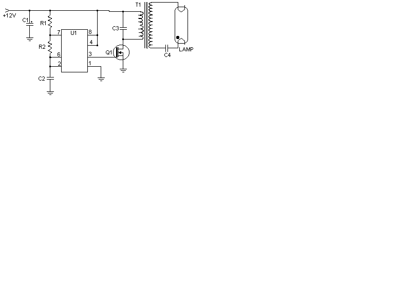

Is this it?
JW
« Last Edit: March 25, 2007, 02:36:09 PM by JW »
commanda
  • Posts: 731
Re: CFL Driver Circuit TESTING STAGE
« Reply #9 on: March 25, 2007, 03:58:12 PM »
At what frequency are you driving it?
Fluoro tubes are far more efficient at higher frequencies. Most (commercial) units run at 10-20 KHz. There are some graphs published on the web somewhere which show typical light output vs frequency. Google is your friend.
I presume that transformer you're using is a mains (60Hz) transformer. Usually won't work much above a few hundred hertz. Need a ferrite core for higher frequencies.
Also, the 555 will need to be a ttl 555, not a cmos 7555. If you get the frequency up where it should be for proper operation, you will almost certainly need a driver stage for the gate of the fet. A bipolar (NPN/PNP) pair of transistors is usually sufficient.
In my diary somewhere is one I made using a ferrite core salvaged from a pc power supply and a fet. This is about the minimum parts count you can get away with.
« Last Edit: March 25, 2007, 03:58:12 PM by commanda »
JW
  • Development Manager
  • Posts: 4055
    • Flashsteam.com
« Reply #10 on: March 25, 2007, 04:06:05 PM »
Hi
"Part Total Qty. Description Substitutions
C1 1 100uf 25V Electrolytic Capacitor
C2,C3 2 0.01uf 25V Ceramic Disc Capacitor
C4 1 0.01uf 1KV Ceramic Disc Capacitor
R1 1 1K 1/4W Resistor
R2 1 2.7K 1/4W Resistor
Q1 1 IRF510 MOSFET
U1 1 TLC555 Timer IC
T1 1 6V 300mA Transformer
LAMP 1 4W Fluorescent Lamp
MISC 1 Board, Wire, Heatsink For Q1
http://www.aaroncake.net/circuits/flampdrv.asp"
Thats were I found this schematic. I guess the circuit could be built and hz measured with various capacitor values, with matching resistors. I think this was first published by Electronics Now magazine. Looks like a fun circuit to play with.

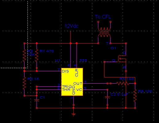

Hello, sorry for the delay. Here is the schematic of mine. Its very very similar since there are not many ways that you can play with the 555 for this kind of task.
As commanda says it is not the best practice to use a mains transformer since they are not designed to run over 60Hz. If you have at hand a ferrite core transformer it will beat the crap out of mine. The only reason that I made it like that is because I only had that regular transformer.
If you make this circuit with another transformer it might not work because of the different characteristics that our transformers might have. Regardless you can make it work by playing with the frequency and the pulse width.
you can use the exact same circuit with a better transformer and your life would be more simple. I dont remember the value of C1 that I used for mine but it is a ceramic disk capacitor. I didnt read the value because I was testing a value if it didnt worked just grab another one (I have a big pile of them) until I hit the right frequency for the bulb/transformer. Once again get a ferrite transformer and you wont have to do that :-D
« Last Edit: March 25, 2007, 05:43:06 PM by s4w2099 »

Hello, according to my meter it measures 12khz. I dont know if its my meter thats giving me a wrong measure. I wish my oscope would be working to actually see whats happening. It is a miracle that that little transformer is actually working at that frequency. I know for sure that the frequency is not 60Hz because I can hear a sound coming from the transformer very very much faster than the sound that power invertes make at 60Hz. Regardless it is being very efficient.
I know that ferrite core is the real thing to be doing this kind of project but I didnt happened to have one so I used a regular one. Its not the first time that Ive done this and all of the times have worked. Choosing a transformer that has about 7 ohms resistance in the primary side would make it work nicely. If its lower the spikes will go back to the chip and fry it.
I understand the driver transistor part because it is commonly used in inverters but I dont know why you would want to use a TTL chip instead of CMOS. I used CMOS because it is harder to fry because the operating voltage is way higher. The voltage spikes from the transformer will not hurt it if you use the suggested resistance for the primary. For sure I can make a more complex model and make it highly reliable but it would defeat the purpose in the sense that you cant just find the parts rolling in your kitchen floor. But I do agree with your concerns. Please let me know why a TTL and not a CMOS.
Thanx
« Last Edit: March 25, 2007, 05:52:17 PM by s4w2099 »
