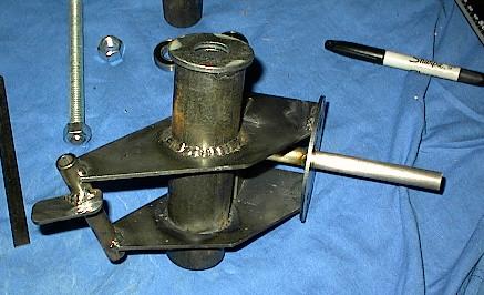

  This one started as thoughts of a small, reasonably powered, lightweight wind turbine.  I also wanted to combine the prop hub, magnet disc and bearing hub into one unit to keep it simple.  I also wanted to keep it simple enough to change stators and try different magnet layouts.   Then I decided it should have adjustable wing mounts for different blades. I also wanted to incorporate a built in assembly jig where all the parts will jig each other to make the assembly super simple. So one thing lead to another and this is the end result...

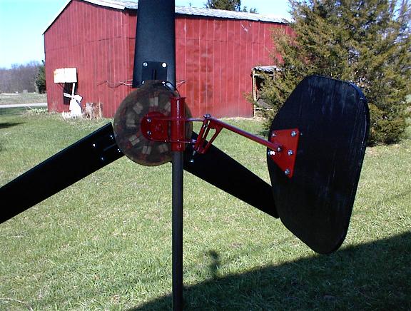

  It weighs in at 15 lbs as mounted on the tower, complete with furling system.  I'm using Jerry's blades uncut and the little unit does a modest 200 watts.   Below is a picture of the unit assembled...
  The small but quite sturdy head assembly...

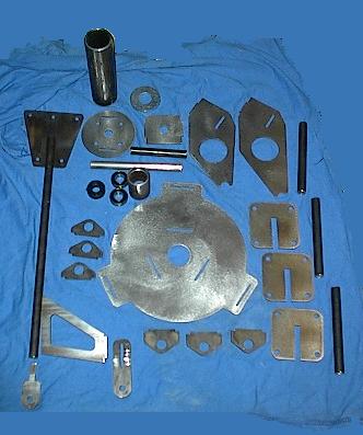

  All the parts cut and ready to assemble the unit...
  This unit doesn't have the adjustable wing angle installed.  The parts are cut just not assembled as yet...

Great work Ed.
Could you list the specs of the unit in the picture? What was the wind speed at 200 watts?
How about a photo of the genny from farther back. Like to see the complete genny to get a feel for the size.
Thanks Ed.
« Last Edit: April 15, 2007, 08:39:28 PM by Jerry »
Re: more pictures please.
« Reply #2 on: April 15, 2007, 09:30:56 PM »
  I'm not sure of the rpm it was running but my wind speed indicator was reading 24-28 mph making 200 watts.   The alternator is simply another 8 inch, single rotor air core.
  It starts charging in fairly low winds, I could drop a few turns per coil and get some better performance out of it.  I wasn't really looking for efficiency in this unit, simply a base to experiment with, somewhat "universal" and simple to change.
  There's no doubt it could produce considerably more power by changing the windings.   I'm using #18 wire in this one, 16 would boost the output considerably.  Just a fun simple project that's easy to modify.

Well that is certainly a very nice looking unit/kit there.
And I like the barn with the big fan. Is that for summer cooling or your wind tunnel :)

Nice job Ed and looks like a nice turbine. Are you selling these as kits or just one of. What is the cutin speed if you know.
Thks
Wayne
« Last Edit: April 16, 2007, 09:30:54 AM by wayne »
Re: Mini 200
« Reply #6 on: April 16, 2007, 10:43:47 AM »
Hi Hannu, A 3ft x 4ft would match the output of the mini200
« Last Edit: April 16, 2007, 10:43:47 AM by windstuffnow »

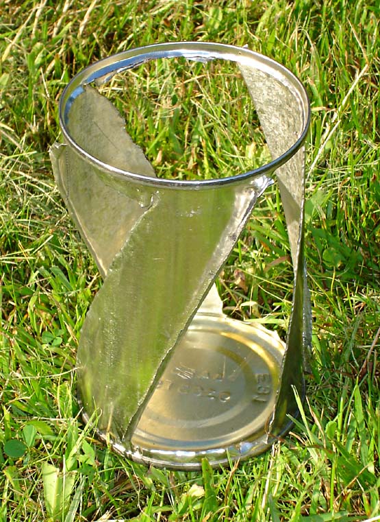

Have you tried to make a Lenz turbine of a drum?
You might do without rods to hold the vanes, just leaving a part of the drum uncut.
You also might try making it with skewed vanes...
« Last Edit: April 16, 2007, 02:35:23 PM by hvirtane »

I've played with various set ups including skewed or offset rotors. I found that you don't gain anything by doing so and sometimes you actually loose.
You are probably right that you don't gain much in power. At least much experimenting is needed to find out the right shape. But I think that the structure is much easier to make strong this way. If the blades are curved there is some structural strength in their form to resist them flexing? That seems to be one of the main ideas, why Gorlov water turbines are made a similar way.
I made one model about 1 m tall and 30 cm wide of a PVC pipe. I used screws to fix some of cut off materials to make J- curves for the blades and an angle grinder to smooth the shapes. Unfortunately the pipe was made of quite thick material and really heavy. It would need quite a storm to move...
« Last Edit: April 17, 2007, 12:19:26 AM by hvirtane »
