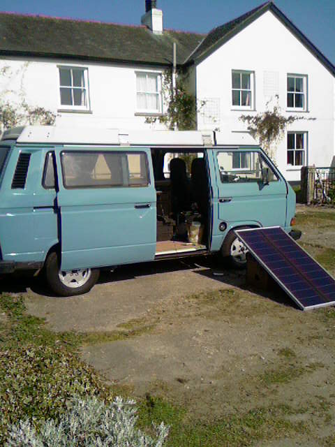

This picture is of my van and the solar pannel i will be mounting on the roof.  At the time i had spent the day using the solare pannel to power my laptop.

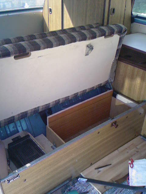

 this is a picture of the bench seat in the rear of the van with the battery box installed.

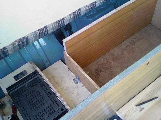

just a close-up of the empty battery box

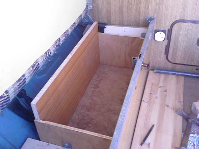

Another one just from a different angle

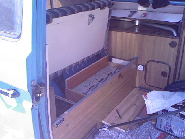

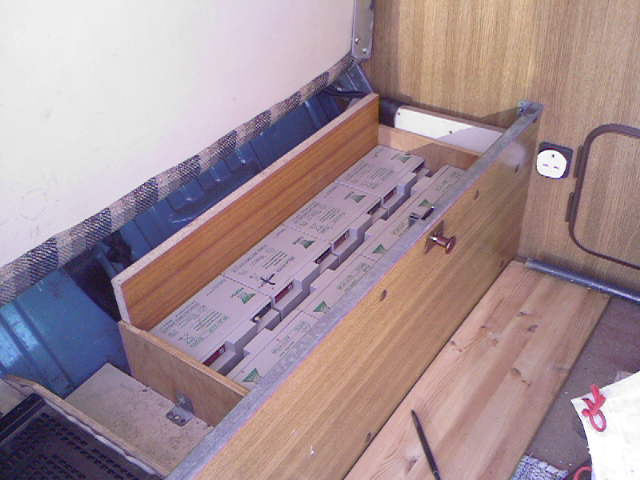

That batteries placed in a battery box ready for wiring up
again another angle.
I have a couple of things left to do with the batteries in the battery box before I will start mounting the solar panel on the roof.  I am currently proposing to clamp the solar panel to the roof with the use of flat steel bar and coach bolts.

Even though you sent me the pictures earlier, still nice to see them again :-) Also the one outside the van I never saw. That panel looks massive.

Very nice box, good to see that you left the sides lower to allow for air circulation.
Also, very nice van. One item that I have seen on the micro-buses at the eath day event this past Sunday was that people are beginning to use those wind-deflector for sun roofs to give their panels a air void effect. One gentleman said he'd had worries about even having his 100watter come off bolted in 6 places until he put the deflector up. Says it made the air rush over the van quieter too.

Do the batteries still hold a good charge? Nice solar panel too, how many watts is it?

Fungus, The batteries still hold a good charge and the panel is a 64watt panel, rekon it should be good for the 192 amp hour battery bank.
