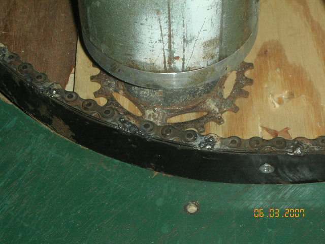

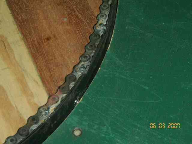

 Any modifications and progress he has made
 on that chain gear...
if he has ever figured how to
keep it trued up...still think it is a neat way
to gear up....or down.

I will add my 2 cents and hope for pics of the mounting of the motors on the chain(?) drive especially how he has them mounted so the pressure can be adjusted between the chain and the sprocket. A little more info on the wings he added to the S rotor and if he thinks that they are helping that much.

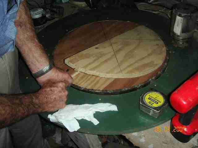

This is a view of Pepa's chain system. Here he's working on popping out the helper board.
Here is a close up view of how he came up with a "fix" for the drifting problem.

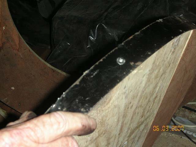

The fix, a metal band around the entire outside of the chain , with the chain spot welded to it. He has plans on many more welds before re-assembling it.
This is the chain system with one of the motors he has ready for the chain. He's also designing a floating rider for them that will allow them to have a little give so to speak.

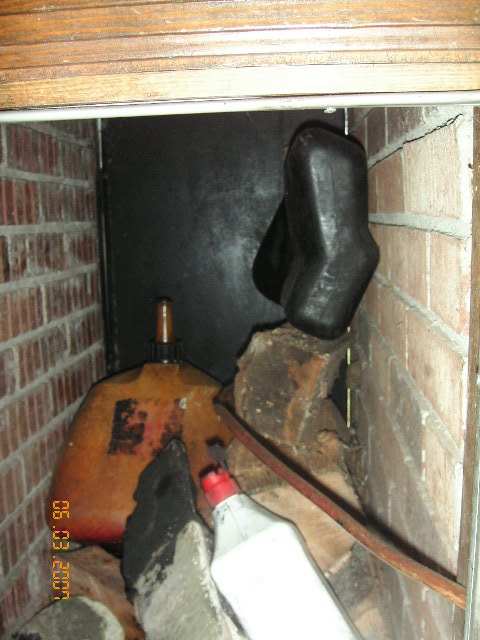

On to the oil burner system. He has routed a copper tube system that allow him to burn oil in the fire place, forgive me but even with the best photo software I could not get it to be viewable, but believe me the is almost no soot on there, which is more than I can say for my fireplace:-)

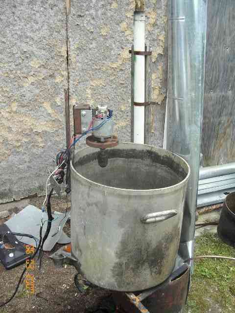

Here is the system that he uses to cook the water out of the worst of his stored oil, also used when he wants to make bio-diesel ( sure wish I had driven the Benz down there:-). Note his homemade slow speed stirrer?? It was made out of a 90Vdc-treadmill motor and controller. He can control that down slow enough tso there NO splashing. SO all those of you getting treadmill motors? Get the controls too (:->
The oil burner for this is the smae as the larger systems but with a smaller external oil supply. rate of oil is controled by the stop cock which once the oil gets hot you can hear it rolling inside the little burner. once heated and even during the heat up time there is almost no viewable smoke. the stack gets hot for sure. No pics taken of toasted fingers ...sorry..

hi Bruce, i thank Ghurd and finis would like to see the converted shop heater burning if you have that picture. if not, i will take a shot to post because i think that is the best way to have good inexpensive heating with the used oil and very little work involved. i have found another good oil heater at my favorite recicle stop and will probably bring it home even though i dont need it at present. i also think that any wood burning stove could be used this way if the burner and supply line were added in the firebox and used in the place of wood. the oil gives a regulated burn and is fed from a tank to eliminate rhe need to keep adding wood all night to have a even heat from the stove. it can also be used along with wood and the ashes make a very good wick for the oil. pepa
