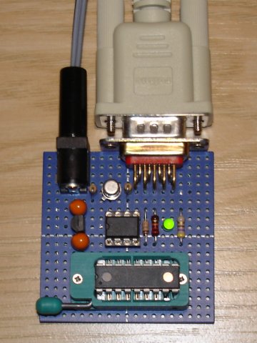

This is for anyone who's been following the PIC saga and might want to try programming a 16F88 themselves.  I just ran across a very tiny and simple programmer (hardware) based on a PIC12F675.  It would be a good second programmer, or a first one if you have someone that can program the 12F675 for you.  It only programs the 16F88 and 87.  I put a picture at http://www.otherpower.com/images/scimages/6871/pp88.jpg
You use it by connecting it to a serial port and sending the hex file from your assembler or compiler to the port.  It can program and verify the program, but that's it (no debugging, reading back the EEPROM, etc.).  It doesn't require any software on the PC beyond whatever you generate the hex files with.  Looks like maybe $5-10 worth of parts involved (excluding the fancy ZIF socket).  The schematic is contained in comments in the assembler file that you program the programmer from, which I put along with a hex file output from MPLAB at http://www.otherpower.com/images/scimages/6871/pp88_code.zip  This comes from http://home.tiscalinet.ch/str/micro.html but I'm using a whopping 7k to put a copy here in case something happens to that.
It looks as though this might work using a 12F683 instead of a 12F675 in the programmer.  The pinouts are the same, and when I assembled the program with a 12F683 as a target the hex file is identical to the one I got when I assembled for the 12F675.  Some people here have been using the 12F683 and I've got a few around, but I don't have any programs working for the 16F88 yet.  So no, I haven't tried this programmer yet.

i have been working with the programmer a lot lately ( blueroom's )
it seems to work flawlessly at the moment
have you got the programmer working?
have you got a 16F88?
what others do you have?
I have a pwm program for the F88 if you want it, i'll have to dig it up though

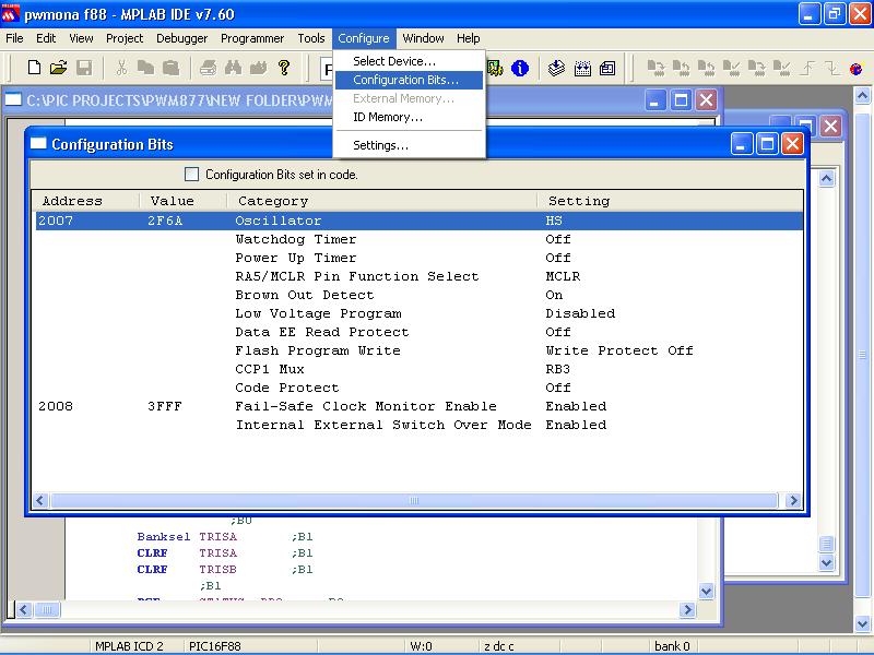

Alan this is a pwm program for the F88.
http://www.otherpower.com/images/scimages/2965/pwm16FF88
it has no config settings because at the time i was using my own programmer, long story..
i have not tried it with MPLAB so i dont know what errors you may get
i had some help with it , hence all the bank switching comments..
it does not use the internal oscillator so a resonator is required , like on the photo of the boost converter , a few diaries ago.
it uses pin 9 for pwm out
and pin 16 for clkin
and pin 17 for An0 ( analog in )
the config bits can be set in MPLAB to overide the programs lack of config bits.
Or if you copy the program below and set the config bits in MPLAB
:020000040000FA
:10000000850186018301831603138501860183120E
:1000100092010030950083161F30920083120C303D
:100020009700121583160130850001309B00403087
:100030009F00831240309F001F148C0121209500E7
:0E0040001E288C1C21288C101E081F1508007D
:00000001FF
save it as a .hex file
set the config bits in MPLAB,
http://www.otherpower.com/images/scimages/2965/mplab.JPG
go to File -> Import and point to the hex file
that should work also

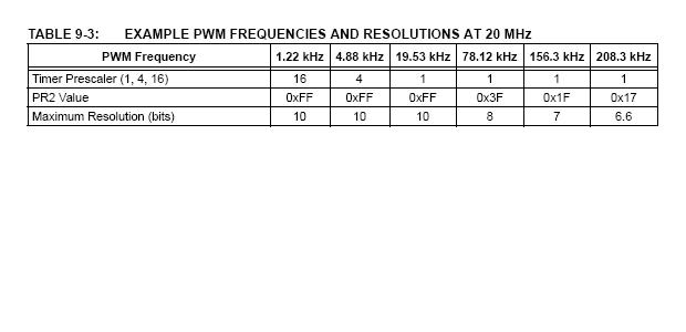

BTW , loading PR2 with a higher value
'3F' will get you 8 bits resolution
'FF' will get you 10 bits resolution
 the downside is the PWM frequency will be less.
I havn't tried 208 kHZ ,but 156 kHZ seems to work well with the boost inductor that i have , i kinda miss the 10 bit resloution though
Also i dont know how the 'A' got in the beginning of the program , there is no 16F88A , just the F88..
