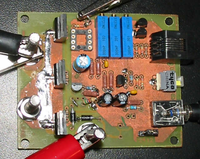

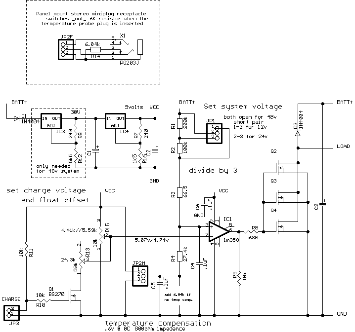

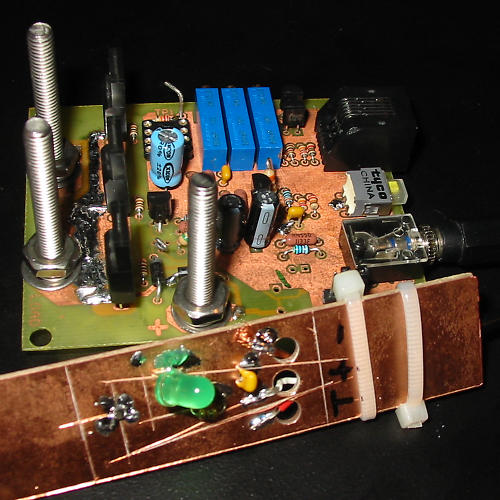

elt
  • Posts: 328
Re: $5 2-state temp comp ANALOG dump controller
« Reply #37 on: September 06, 2007, 10:43:37 AM »
I think this is it!
http://www.otherpower.com/images/scimages/6527/tiny_14s.gif
I removed that resistor on the bottom of the battery divider chain (that was inserted to provide a reasonable default temperature if the temp sensor became unplugged.) As you pointed out, it attenuated the temp sensor. I'll put it on the switches for a stereo mini plug that I'll use to attach the sensor. I always have to play with those things to see if the switches are NO or NC so the connections show at the top of the schematic might not be correct.
I changed the derivation of the charge voltage reference and float offset so that the switch would default to float mode and activate charge mode by grounding the input.
Because the temp compensation curves varies from linear, particularly at high temperatures, I shifted the resistor values slightly to center around 25C rather than 0C. I think this follows the curves better. The cold voltage may be a little low but I thought that better than having the hot voltages too high.
Am I ready to etch copper? My preliminary layout still has this all on a one-sided board!
 - Ed.
« Reply #38 on: September 06, 2007, 02:25:54 PM »
You have the power fet gates on a single resistor.  I thought that caused a problem before.
"The cold voltage may be a little low".
Think happy thoughts!  If the controller is controlling, the battery is charging, the inside may be a bit warmer than the exposed temperature probe?  Kind of balancing itself out?
« Last Edit: September 06, 2007, 02:25:54 PM by ghurd »
elt
  • Posts: 328
« Reply #39 on: September 06, 2007, 04:07:09 PM »
Hi ghurd,
Scott wrote up-thread:
In the spirit of parts reduction: Gate resisters [r8, r16, r17] are not needed. Gate resisters are used to isolate the driver from the capacitive load in high speed circuits. We are not high speed here.
BTW: I did put in .1 uF cap center of the the 100k pot in the bread board (actual values .08 uF and 88K) and the circuit ran at about 800 Hz and then slowed downed to 0 Hz. I haven't tested it with real loads yet as I don't have real FETs; I do have a couple tubes of irf530's that I use it for low current tests.
It's been hard to find a nice op amp that costs less than the tinyAVR micro processor but I think I did, a ts921. It's rail to rail, up to 12 volts and has a whopping 80ma source and sink capability. Costs $1 to $1.50 USD depending on who has it.
I think you're probably right about battery temperature vs. cold weather; the case or terminal would be losing some temperature to ambient so it seems likely that it would read a little low... Good point!
- Ed.

scottsAI
  • Posts: 884
« Reply #41 on: September 08, 2007, 10:38:31 AM »
Elt,
I did not see this yesterday. Buried in all the posts.
I agree I think that is it! (OK couple comments)
I dis-like pots. The wiper gets dirty over time and causes problems like becomes open. R13 connect pin 2 to 3, that way if it opens it will still have something there. Would like to do something like that for R15, but with how its used, can't.
I very much dis-like connectors, even expensive ones go bad over time.
X1 is a great idea until the contact don't make connection. I would feel better with a simple 3 pin connection and the resister (R14) back in the bottom of string R1-4, if the probe is removed the circuit will still work. Measure the attenuation with R14 back in the circuit. I'm expecting less than 8%, for the long term benefit I would feel better with it on the PCB. You can always remove it.
Opamps: Request a sample or two (I always get two), like OP196GS, will ask future volumes, use less than 1k or someone will end up calling you.
Great work!
Have fun,
Scott.
« Last Edit: September 08, 2007, 10:38:31 AM by scottsAI »
elt
  • Posts: 328
« Reply #42 on: September 08, 2007, 12:12:27 PM »
Thanks Scott,
So that's why people do that! I try to learn something new every day; now I can go to sleep...
> I dis-like pots.
I think I have to have at least one pot somewhere. I'm pleased enough (probably through ignorance) with the voltage curves to put in fixed resistors but I still have to account for the difference in actual versus nominal voltage out of the voltage regulator. I've used digital pots in a couple of circuits and don't have a problem with them but I've tried to set those reference voltages to within 3mv and it'll take some fixed biasing resistors (more parts) to allow the low resolution of the digital pots to give fine enough control... it just seems too complicated to me. There's not really any fault detection in the circuit; it's going to need checking on no matter what... I'm hesitant to take the pots out.
Okay, you've convinced me. I'll put that resistor back in the bottom of the chain. What I didn't like with it there is that it seemed to widen the offsets at higher voltages when narrowing them is spec... still I think in the name of "robustness" that that's the spot for it.
>  OP196GS
That looks like it only has a +/- 4 ma output (and, samples aside, costs more than a microprocessor!) Would I need a FET driver with that?
Thanks again!
 - Ed.
« Last Edit: September 08, 2007, 12:12:27 PM by elt »

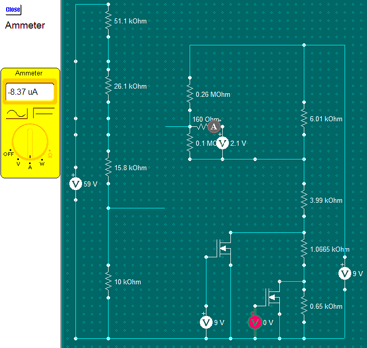

scottsAI
  • Posts: 884
« Reply #45 on: September 09, 2007, 08:51:52 AM »
Ed,
Simulation with 4.1k bottom resister. No temperature. 60V battery all tests.
Node voltage = 615.11mv (close to 600 mv target), + input opamp = 5.026v.
At the 48v battery 30mv/c = 120mv/c
Assumed Temp sensor output resistance was 400 ohm (800 max, normal should be much less)
temperature
  1. mv: Node = 601.36mv, + input 5.013v
  2. mv: Node = 610.46mv, + input 5.022v
  3. mv: Node = 692.38mv, + input 5.097v
  4. mv: Node = 783.40mv, + input 5.181v (jumper 3pin = 15.13v
  5. mv = 20'C, the battery voltage should be 30mv*20 *4 = 2.4v drop. Or 57.6.
Entered battery voltage 57.6v, = + input 5.002v! Looks close to me!
57.75 to get back to 5.013. (600mv starting point). 150mv error or 1'c equivalent error.
How accurate were you targeting?
Have fun,
Scott.
« Last Edit: September 09, 2007, 08:51:52 AM by scottsAI »

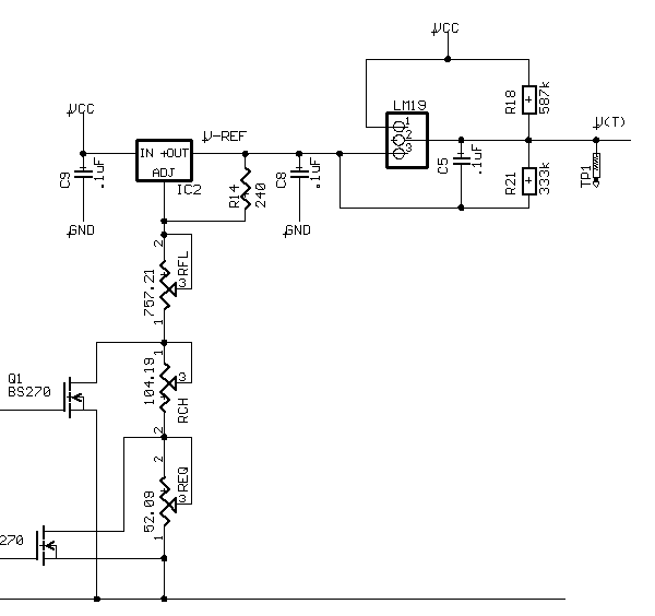

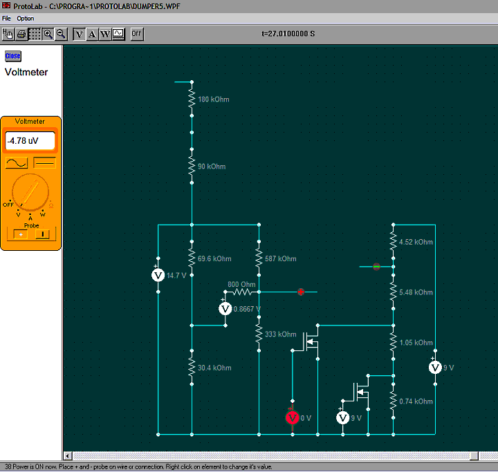

elt
  • Posts: 328
« Reply #46 on: September 09, 2007, 11:35:57 AM »
I think that we're both correct!
At 60 volts the attenuation is 30k/400k, about 7.5%
At 15 volts the attenuation is 30k/100K, about 30%
I tried floating the sensor ground on the battery divider. That gave very good temperature compensation at all voltages but that also raised the voltage of the sagging regulator problem to about 5 volts. I think I like floating sensor but would like to find an op amp with an enable line. Otherwise, I think that just a warning that if the battery volts drop to 5 volts, the dumper might take it down another half volt or so... That's not a problem if 3.75 volts (the regulator drop) won't turn on the FETs but if it will, it will drop the battery voltage volt for volt until the gate voltage is too low.
What do you think of floating the temp sensor on the battery divider?
 - Ed.
« Last Edit: September 09, 2007, 11:35:57 AM by elt »
scottsAI
  • Posts: 884
« Reply #47 on: September 09, 2007, 01:49:45 PM »
Ed,
The placement of temperature sensor above R4 or Below R4 should not matter.
If your simulation shows a difference then something is wrong.
I did it both ways and as expected they were exactly the same.
I tested with 15v battery and see a difference in temperature compensation, from when I did it at 60v.
Have fun,
Scott.
« Last Edit: September 09, 2007, 01:49:45 PM by scottsAI »

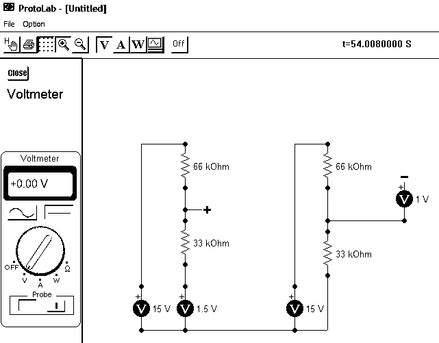

  • Posts: 328
« Reply #48 on: September 10, 2007, 09:08:24 AM »
Hi Scott,
I must not have said or shown it correctly; I'll try again -
http://www.otherpower.com/images/scimages/6527/2scott.gif
It takes 1.5v at the bottom to be the equivalent of 1v floating in the middle.
The problem I'm seeing is that the 125uA load of the sensor is about all that's going though the divider... looks like it'd take changing the divider to resistors on the order of 1k, 2k, 3k 6k to make the sensor load reasonable on the divider network. Otherwise, it might take going back to two op amps to do temp comp to spec. Spec? The Trojan web site say 14.7v charge at 80F and 30mv per degree C compensation. Is 20mv/C good enough? I don't know; it sounds better than nothing but I don't like seeing it dependent on system voltage.
I think i see four choices:
  1. Float the sensor, reduce the divider resistance and accept 5ma of drain when "idle"
  2. two op amps
  3. don't sweat the reduced compensation at 12v; it's pretty close at 24v and 48v
  4. Something else.
What do you think?
Thanks again!
- Ed.
« Last Edit: September 10, 2007, 09:08:24 AM by elt »
scottsAI
  • Posts: 884
« Reply #49 on: September 10, 2007, 11:11:46 AM »
Hi Ed,
OK, the two circuits as you know are not equal.
Try to build with actual devices the second circuit. And simulate it. Easier to use two opamps.
I expected a little interplay when putting the temp sensor on the bottom, with 10mv per c didn't seem like enough to be a problem. With the low mv accuracy we are interested here it looks like it's causing more error than you want.
With 12v battery, 0'c, 15v at 20'c should be 14.4v yet is 14.6v 200mv error is 1.2%.
I looked could not find it... wanted something like 40'c operating range?
With 40'c rise in temp error is 400mv. 2.75%
The voltage reference needs to be looked at to have a prayer of making 1% with 40'c change.
Choices:
  1. live with it.
  2. lower the setpoint voltage: divide by 3.75 vs the 3 now. The battery temperature will then be 8mv/'c at input of opamp, just about where temperature sensor is now.
  3. Use two opamps.

elt
  • Posts: 328
« Reply #56 on: September 12, 2007, 05:36:44 PM »
This is really a reply to this post:
I used 4v at the opamps inputs. LM61. Using 400 ohms output.
15v, R1 = 73.33k, R2 = 22.66k, Temp sensor 4k at 0c 4.000 volts opamp inputs.
With 0.8 or 20'c, Vbat = 14.415v for 4v
with 1v or 40'c, Vbat = 13.84v for 4 v.
If calibrated for 20'c first the error would be half. Or only 20mv total!
I went up thread to get some room...
That's nearly identical to what I came up with (but yours is a little closer!)
I used a 5.75k  R at the temp sensor because I thought if it were unplugged or failed it would be safer to simulate a higher temp. I think 5.75k is 20 or 25c. Given that, I lowered R2 a little to compensate... I still get about .1v error from "ideal" if I run the the voltage and temperature range. I imagine that's good enough!
The design, however, has an intrinsic non-linearity. I see that because if you divide the input and output voltage of the battery divider you get (about) 3.6x but if you look at the incremental voltage step on the output seen by raising or lowering the voltage you get 4.1x I feel like I've been chasing numbers around for two days trying to get the best fit to the curve.
This...
... floats a sensor on the "fixed" side with the charging references so it does not have that issue. I believe that its accuracy is only limited by the available values for the fixed resistors. Using in-stock 1% resistors from Digikey, I get an error typically 34mv or less across all voltages and a worst case 60mv for a 48v system. I know that you haven't been keen on floating the temperature sensor and I'm not sure why... in this case the LM19 only draws 10uA so I don't think it'll load the divider network it's riding on.
I'm not sure however, whether the output of the lm19 is sourcing or sinking. The spec says it'll source 1uA and sink 16uA.. I think I have it sinking about 8 uA (Worst case is at the cold end when its output is about 2.1 volts)
Is this a bone head idea? (I know I've been hanging on to the idea of floating the temp sensor like a dog with a bone!)
Thanks again!
- Ed.
« Last Edit: September 12, 2007, 05:36:44 PM by elt »

elt
  • Posts: 328
« Reply #59 on: September 13, 2007, 04:13:13 PM »
Hi Scott,
I though you would like to know I look forward to what your going to come up with each day.
You have gone so far past any reasonable expectation of "help" that I am at a loss as to how to express my gratitude... Thank you.
[...] design the floating sensor with real devices and simulate it.
My simulator (ProtoLab) is basic to the max; it has a handful of discretes in it and is not extensible. I've been through the first of Orcad/PSPICE examples; I think I'll build the circuit and see if it works before I'm able to simulate current loading variations of temperature responsive devices!
I'm looking at making the reference voltages "regulated" so I don't have to worry about the sensor load.
I looked at some "precision voltage references" but they didn't seem that much better than the lm317 over the -10c to 40c range so I have not referenced them.
One thing I like about this geometry is that it's very easy to set the setpoints for different charging preferences... just note what the voltages should be at the current temperature, divide them by 2.58 (the divisor on the battery divider) and dial them in.
Okay, it adds another vreg (and its 5ma minimum load requirement) but I think this one is bullet proof... perhaps I think I'll add a LED to the temperature probe at the battery end; that'll at least let me know if two of the three wires are connected. I could put a LED on the sensor output (at the battery end) if I can find a sensor with a neg coefficient and a bit more capacity to sink than the LM19 has...
What do you think of that?
 - Ed.
« Last Edit: September 13, 2007, 04:13:13 PM by elt »

I used the 530's on the breadboards because I have a bunch of them. I figure it'll take some $2 FETs to get to 40 amps on 48v systems. Newark.com has a promo on IRFZ48Z for $1.05 USD (Rdson=.011 Ohm). I figure three with little heatsinks will do 40 amps on 12/24 volts systems.
I etched a board set... battery shown for scale.
I put connectors and a switch across the top of the board. (The footprint can be wired to if you hate connectors...) After the fact, I've learned that I used the footprint for a $4 switch instead of a 40 cent switch. I'll address that if there's a rev two...
You can't tell from the top side but, per ghurd's suggestion, there is an optional power connector and some solder pads on the bottom side so that you can set it up to sample the battery voltage with a second (low current) wire set that won't have a voltage drop due to high current load.
The trim pots, test point, connectors, jumpers and switch positions are labeled; I just transfered the labels to the top (etch) layer before making the artwork.
There's only two holes for each FET. I'll bend the drain pin across the drain plain on the top (and the ground pin across the ground plain on the bottom) to get lots of pin in contact with the plains. I've learned that by soldering the gates first, you can bend the device a little to put pressure on the pins you're working on to get good mechanical contact with the plains before you solder. Also, I made a ground plain over the circuit area to save on enchant. :) I've lost my fear of making two layer boards. If you get two pins aligned, the whole top layer is aligned so all you have to do is make sure get two pins aligned...
Next thing is to see if it actually works!
Thanks again,
- Ed.
« Last Edit: September 14, 2007, 03:44:21 PM by elt »

Hi Scott, hope all is well.
I'm stumped and I hope that you can help me.
I've built the circuit and the main board works fine ...
... well, my reference voltage switching didn't work right because for "float" voltage you have turn both mini-FETs off; a switching diode on the switch fixed that...
But it's the temperature probe that is confusing the heck out of me!
When I plug it in, it somehow raises the reference voltage a volt or so. For example, the float reference voltage (before the temp sensor) is about 3 volts. When I plug the temp sensor in it rises to about 4 volts.
(Here's the schematic- http://www.otherpower.com/images/scimages/6527/tiny_29s.gif)
I've tried and tested just about everything I can think of and it looks like there's some interaction between the temp sensor chip and the LED that effects the regulator, IC2:
  1. When the sensor is plugged in, the 1.25 volt reference on the lm317 stays at 1.25 volts; the voltage at the low end of R14 actually rises. The main supply stays constant at 8 volts; the difference between vref and v(t) is the 1.8 volts as expected by the ambient temperature. (Am now using an LM94022, LM20 compatible temperature sensor.)
  2. I built a "probe" without the temperature sensor (LED, resistor, cap) and the circuit works as expected. (A "default" reading on v(t) is provided by the on-board voltage divider. R18, R21.)
  3. I have a dual independent power supply so I put a 1.8v on the temperature wire of the mock probe, varied it a little bit, and the circuit worked as expected.
  4. I tested the probe by itself with a standalone power supply and it works as expected.
  5. I built a second probe and it behaves just like the first one does.
  6. I cut the connection to the LED on the second probe and the V(t) works fine!
... so it looks like I can have the LED or the sensor chip but not both!?
I can live w/o the LED though I wish I knew why; I think it was a nice idea.
The only clue I have (and what gave me the first clue) was that voltage was only pulled up 3/4 a volt on the second probe and the only difference was I put a smaller resistor (470 vs 2200) on it so the LED would be brighter. I know that the lm317 is a "floating" regulator but I just don't see the way that the probe interacts with it ... I imagine it has something to do with sourcing and sinking across the lm317 output but I just don't see it.
As always, help is greatly appreciated.
Thank you,
- Ed.
« Last Edit: September 27, 2007, 03:47:51 PM by elt »
scottsAI
  • Posts: 884
« Reply #63 on: September 28, 2007, 10:33:27 PM »
Hello Ed,
Just by accident I checked this. You should email me if on an old post.
For me that was 14 post ago and 14 days don't usually look that far back
IC2 is a series regulator, it has no ability to sink the current from the LED.
If no load on IC2, the LED's current will pull it high.
Think of the regulator as a variable resister connected to the Plus supply.
You know the LED will not be lighted!
Fix by placing a load on the V-REF slightly larger, use a Power OK LED.
Yep, that simple! You almost had it.
Looking good.
Have fun,
Scott
« Last Edit: September 28, 2007, 10:33:27 PM by scottsAI »
elt
  • Posts: 328
« Reply #64 on: September 29, 2007, 07:44:54 AM »
>  Fix by placing a load on the V-REF [...]
That worked!!!

Here's a picture of the second probe; no etch or wiring this time, I just cut four islands in the copper with a razor knife and soldered on parts.
The two probe readings match now to a little better than two degrees, that's within spec... now I'll put the op amp in and do some more testing.
Thanks again!

Hello Ed,
Creative way to make the probe!
How will you attach it to the battery?
I hear measuring the temp of a terminal is better than the case.
Be careful to electrically isolate it.
Have fun,
Scott
