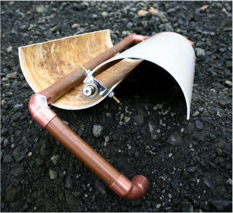

<BR><img src="http://www.otherpower.com/images/scimages/8639/6qv_a.jpg" width=80%><BR><BR><img src="http://www.otherpower.com/images/scimages/8639/6qv_d.jpg" width=80%><BR>
Let me say up front that the copper pipes and pipe fittings were handy and are on loan from my boss - he's got lots of scrap gathered up from over the years - it's not soldered together and will get replaced with pvc. I didn't have enough 3/4" pvc fittings laying around is all. I think when I switch to pvc for the frame I'll bring the pole down the center line of the vawt. I'll probably use a galvanized conduit pipe for the pole and will want to add guy ropes to it with stakes on the ends....think camp charger.
The OD on the rollerblade bearings is the same as the ID of 3/4" fittings which is handy. For some reason I'm using two sets of bearings on each end as you can probably see in the second picture but I doubt I need to. I'll remove a set from each end later and see how that works out.
You should be able to see the flat "L" corner braces turned into a "U" bracket. I don't like that there's only one bolt on each end holding the pvc on but these 1inch "L"s were the best I could find. Having just one hole makes it easy to align tthough - so if you plan to make one and you can find better Ls (or "U"s, let me know!) with 2 holes then start with one bolt, get it aligned, and then drill the pvc and set the other bolt.
The air gap is 1 and 1/4 inch on this one. On the 4" version it was 1". I don't care so much about efficiency though so maybe more/less gap would be better. You can easily change the gap though by changing how you mount the blades and adding extra nuts.
I'm not sure if top/bottom plates add efficiency to this or not, I've just never tried adding 'em. Some kind of bottom plate will be needed to protect the bottom bearings from rain (which you'd need for the alt anyway) so if you're a symmetrical kind of person then a top plate would be required too.
I think this part is pretty much in the bag at this point. There's not much to it and all these parts together shouldn't cost too much. Garage sale rollerblades, some pipe and pipe fittings, 4 Ls and some bolts. The only thing left is the alt, really. I guess that's the tricky part though so I'm all ears as far as that goes.

Looks interesting. Good work. Heres one on youtube that looks very similar and about the same size. They can really spin.
http://www.youtube.com/watch?v=lUpXokjLF1o
I was thinking of doing one out of the 6" pvc drain pipe like yours, but make it 8 feet high!  There just don't seem to be enough torque with only 2 feet. You may not even need a top bearing. I just made a prototype that is 39" high (18"diam) ,and it is alittle off balance in lower winds, but when the stronger winds hit it, it staightens up perfectly and spins really nice! I didn't expect that! I even saw it survive what had to be a 70mph+ wind during a terrible thunderstorm last week. It seriously looked like a hurricane on TV! -That was amazing and mega surprising. The one I am almost done with now is 5 feet high with no bearing at the top. (2 feet diam)
You might think about making it 8 feet high and direct drive an ametek motor.
Keep up the good work. Can't wait to see that PB-Vawt up in the air go!

Taller/bigger would be better for a permanent windmill but I really want something portable. I was thinking of building in a spot for a 9.6v RC-car battery pack (swapable of course) and building in led lights. Portable self-charging lamps for when we go camping. With that in mind, I don't want them to be too big to pick up and take into the bushes when nature calls.
I'm not sure about bottom-only bearings. Especially as you go higher, it just looks flimsy. That's just how I feel about it though - I'm a symmetrically-minded person so top and bottom bearings are basically a must just on those grounds. I can see how it would tend to straighten up when it gets going though - it's like spinning a top when you think about it.

« Reply #9 on: October 03, 2007, 06:00:33 AM »
i suggest you replace the bottom elbow with a t type fitting
then run a longer central shaft right through it.
attach a steel disk to the central shaft
use that as a platform for your magnets.
« Last Edit: October 03, 2007, 06:00:33 AM by electrondady1 »
Re: 6 inch quick-vawt
« Reply #10 on: October 03, 2007, 06:17:27 AM »
You really should put a Top & Bottom plate on there. They help to contain the air and keeps the air from spilling off of the ends of the pipe. They also have the small effect of straightening the air making less turbulence.

I have a feeling that will explode in big wind.
Might add a length of all-thread through all 4 layers about the middle?  Like the 'U' bracket bolt, but a lot longer.  Not sure it'll help, but don't think it'll hurt.
About any 99 cent stepper motor (old printer in the basement?) will get it charging AAs or lighting LEDs.

Woof, I kind of want the air spilling out the top though...
Each blade is only held on by 1 bolt on each end. This one isn't intended for really high winds...20mph gusts max. The blade area is pretty small too so that should help keep it from exploding. Besides that, it'll only ever be about 5ft off the ground and will be within arms reach when it's set up.
If the blades were any taller (and the set up more permanent) I would definitely use heavier-duty brackets, more bolts and at least one bracket/bolt of some sort in the middle. Top and bottom plates would likely improve efficiency (if they don't add too much weight) but I'm willing to trade on this one...I do need a bottom plate of some kind though to keep water out of the bearings.
