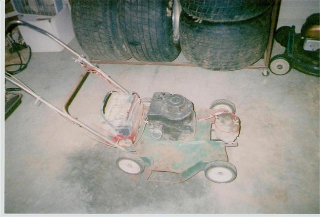

 I just thought I would introduce myself, before I ask a question. I found this site while looking for ideas for a little cabin(shack) in the woods. I've enjoyed reading this site enough that is a regular place for me to check, almost daily. I'm not out to save the world, but I love the DIY way of thinking. I'm going to try to post a picture,(a bad picture) and ask a question; Am I showing the early signs of the illness that y'all have? If so, I guess you can be expecting questions from me before to long.( I promise to do searches first) Thanks for the hours of good reading so far.

Welcome to the board.  I like it.  A clever use of a vertical shaft engine and wheels too!  See a lot of those go in the metal recycler with working engines.

agreed, that is a pretty nifty design for a portable gen!

Many mowers/edgers are thrown out after just a few years. The air filter is often rarely cleaned or replaced so it ends up clogged which leads to a rich mix and fouling of the plug. That, of course, leads to difficult starting, and finally purchasing a new one. New foam in the filter and cleaning the plug tip is often all thats needed. (Leaving the filter off may cause it to run too lean)
The weight of the stock blade also performs as the flywheel, so if you remove the blade it may start easier with a heavy metal pulley. Do you have the cabin yet? (I'm researching RE for a retirement home, so I havent actually built anything yet)

 I didn't knock myself out on this. I took the blade off, made an adapter, and bolted an old chevy water pump pully in it's place. If I had known it was gonna work this good, I would have spent a little time making it look better. It's not in the picture, but I've got a tray to go on the handle that holds a cheap 500w inverter. With the inverter, new spark plug, new air filter and new muffler, I have a total of 39 bucks invested.(29 of that was the inverter)

You should be aware that mower engines, being one cylinder and high RPM, have a somewhat limited life - especially in relatively long cycle duty.  They get a lot of power from a small piston by moving it around very fast, so they put more wear on bearings than a slower engine with bigger pistons and more of them.
Automotive alternators, too, have issues with bearings failing after a while:  100,000 miles on a car at 50 MPH is 2000 hours run time - about 83 days continuous, and that's about where they go out.  (Of course they'd probably be running at higher RPM than they would on your mower conversion so they might last longer, since they're at the mercy of the car engine's RPM and have to generate at idle but spend a lot of time at acceleration and cruising engine speeds.)  That's a good match to the mower motor but would be horrible for a wind turbine.  B-)
Anyhoo:  If you end up running this for a couple hours a day figure on it lasting maybe a year or so.  That will give you time to arrange other power sources if this is your only power supply.  (You might want to get another junk mower and a spare alternator for a backup meanwhile.)  If this is just to have 12V available intermittently, you're done.

You have enough power from the alternator to charge a bank of batteries and the alternator will do 110 with a few modifications . Of coarse transformers and ballasts get warm pretty fast from the high frequency .I was going to link the alternators secrects page for ya but they took it down so I saved a Pdf of the page and here's the link from saved  files .

 Thanks for the info, and kind words. I don't want y'all to get the wrong idea, this is not something I would depend on. I was thinking, charge a couple golf cart batteries, to have enough power for a few lights, etc. That way I wouldn't have to listen to a bunch of noise, except for a little charge time, now and then.

It looks pretty just the way it is.Would be a good testbed for a small induction motor also to run lights.

My old Sears rider is at 25 years on a brigs 18hp V-twin. Uses some oil now but keeps on running :-)the bearings in a car alternator aren't much different than what you find in some motors so life span would be quite a bit longer if they are kept out of the conditions found under a car hood. extreme cold/heat, wet, dirty, dusty, road salt in northern states.....

You might get a kick out of reading this site:  http://www.qsl.net/ns8o/welcome.html  You might consider swapping the alternator for an induction motor and seeing what you get out of that.
