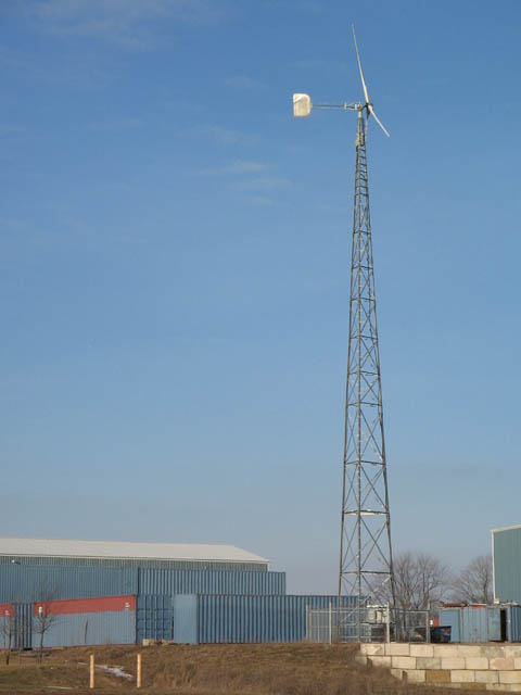

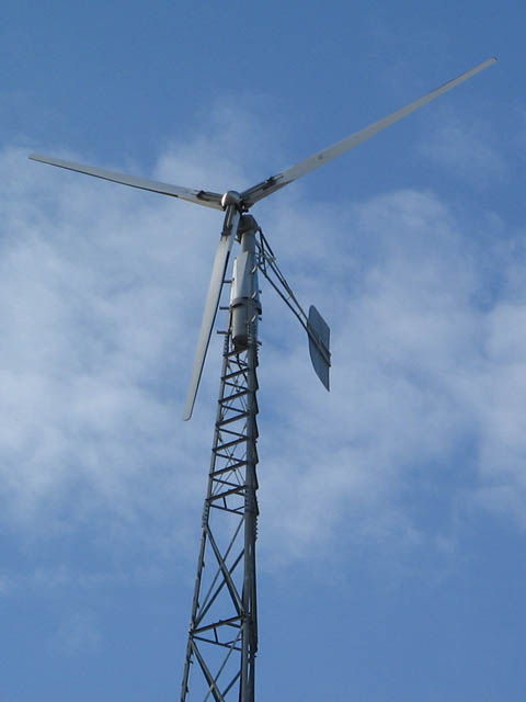

 Here's a photo of Dave Moller's handy work during the tail pivot mod of lessening the angle. He torch cut through just down near the bottom and here was grinding stock away at an angle so that with some heat and a little push things would butt neatly back together. No fuss no muss then stick welded back together several passes both sides and presto, reduced angle by about 3 degrees, maybe moved the pivot in about 1/2" at the top of the support plate.
 While he was doing the serious stuff he let me borrow his spray booth to paint my newly completed stator, it's now gloss white enamel. Besides looking nice I figured it would help with UV protection as the "Wests" epoxy manuals all suggest some type of coating for this reason to the bare epoxy. I know this could limit even more the internal heat transfer but I now know the limits of this material and plan to stay well below worrying about a stator burnout. In fact choosing gloss white will help reflect the radiant from the sun during those dog days of summer that I hope we will see sometime again.
 New 9' (probably Ash) blades carved on Dave's machine should be happening soon while I replace and pack new hub bearings just for kicks. A few other little ideas we have to improve some things too and I'll update on that as it happens besides. It will be great to have it back up again and to test the improvements, heating water direct sounds simple and is but matching the load to the blades for more over all efficiency is the challange, did someone say MPPT ?...I'm getting there. Dave B.

Dave B,
What was the angle before modification, and what is it now? Reason for change?

I think Dave said we went from about 16 degrees to about 13 degrees. I'd like to know for sure so don't quote me on that or figure to use those angles as a suggestion. My application is a little different than most here in that I am heating water direct so changes have been made from the start and along the way as I learn more. You can look back through my diary entries for the history but this tail angle change was made from furling too late and over speeding. This should help get me closer to where any other furling adjustment might be possible with tail weight changes. Dave B.

Thanks, yes I can't wait to get it up flying again. I purposely ran the machine above double the rating that I planned for once I realized it was only going to fully furl in very high winds. I did this to find it's limit as it is not very often we have sustainend winds here over 50 MPH. I have a manual brake and could have shut it down (this has worked fine in winds of nearly this speed before) but then I would not have learned what it could take or how to further protect itself when these winds happen again (they will sometime). I don't want to think about baby sitting it when 50 MPH winds are in the forecast, that way 95% of the time I shouldn't be too concerned and it will just do what it should, heat my water. Thank you for your comment, updates to follow. Dave B
