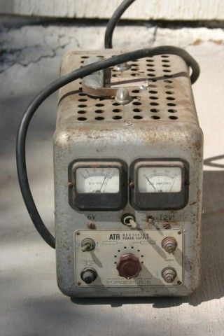

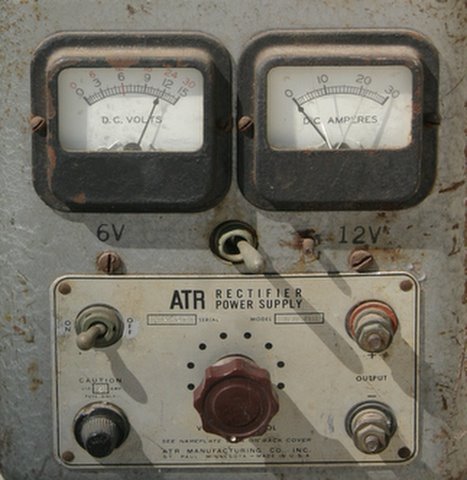

I have had this rectifier power supply sitting around for years. I finnaly took a look at it and I believe I could charge a battery with it, am I correct in my thinking?
« Last Edit: August 19, 2008, 04:54:53 PM by Wheeler »
Re: Living Off Grid
« Reply #49 on: August 19, 2008, 08:11:52 PM »
Maybe.  It is a power supply.
The voltmeter is reading about 11.5V.  Not much good to charge a 12V battery, which should be charged up to about ~14.4V.
Does that knob adjust the output voltage?  Probably have to connect a battery and increase the voltage, without getting the ammeter reading too high.
« Last Edit: August 19, 2008, 08:11:52 PM by ghurd »

I will give it a try when I get back to the ranch in the morning.  I thought I could try it on some of the tired batteries and see how it reacts.
« Last Edit: August 19, 2008, 09:09:19 PM by Wheeler »
