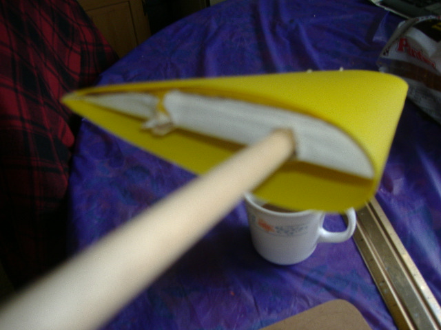

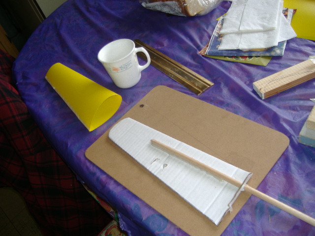

Trying to make some quick cheap blades....but
with me not so quick.....well anyway I'm mostly
just wanting to know does the windward side of
the blade really have to be pretty flat? does it
affect performance to a large degree?
Waddaya think? the dowel stub goes in the hub and
pitch of the blade can be adjusted....the cardboard stretcher will be made from that
clipboard 3 blades to spin one of those little
Rubber Tire stepper motors of Ghurd's
(cute little motors BTW), about 200 -300 rpm will
charge a few AA NiCads !

No it doesn't have to be flat, in fact I can't think of an aerofoil that is truly flat Although ClarkY is nearly so.
Flat is nice and easy for hand carving and works well enough. The front face can be convex or concave depending on the choice of aerofoil. If you use other than flat you will need different angles from those commonly used. Concave front faces are associated with high lift sections and may be good in low wind. Most of the larger commercial machines use convex front faces for greater structural strength with spars up the middle.
Symmetrical shapes work ok if you choose the correct pitch angle, but you will have to experiment.

Re: prop shape needs to be flat on windward side?
« Reply #2 on: May 12, 2008, 12:41:58 PM »
Which should be easy enough with each blade being
on a dowel rod....just have to twist all of them
at various angles until I get the happy medium.
Thanks for being so thourgh in explaining Flux.

« Reply #4 on: May 12, 2008, 01:55:55 PM »
Yellow plastic from folders (office supplies
at Dollar General) enough for 2 blades 48 cents
figure dowel rod ....foamboard...hot glue, duct tape
complete windmillwith RT stepper about $2.50 + labor $5...
( I work cheap !)LOL
« Reply #5 on: May 12, 2008, 02:26:49 PM »
For a wind-facing horizontal-axis machine you want the blade airfoil to generate lift that pulls the blade both rotationward and downwind.  This efficiently decelerates the wind and uses the resulting power to spin the axle.
While you can generate lift with a symmetric airfoil by picking an appropriate angle-of-attack, efficient designs tend to be more like an airplane wing - strongly curved on the liftward (downwind and forward) side, nearly flat on the anti-liftward (upwind) side.  If I understand it correctly:  This builds in a tendency to bend the passing airflow in the appropriate direction and keep it "attached" to the surface for a broader range of angles-of-attack.
« Reply #16 on: May 13, 2008, 07:44:27 PM »
Yes the yellow thing is more like the bottom one
Had all three made today....got a couple of brief
6mph gust...just a glimpse that it might work.
  I think it's too large going to shorten the rods
so it will be 30inches from 36inches estimated
about 120 rpm (no load) ....need more research
( that's spelled more wind) they so seem to work
well....but maybe not good enough...fun nevertheless
(about 8 cups coffee later)
« Last Edit: May 13, 2008, 07:44:27 PM by Norm »
