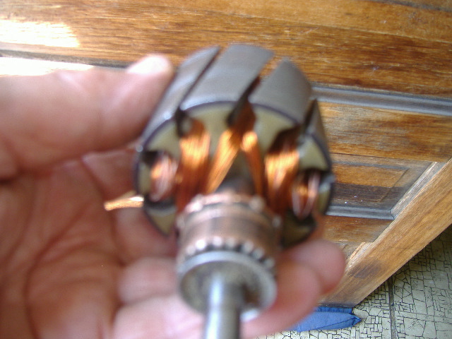

then skip over and fill slots 8 and 9 continueing in the
 same direction as viewed thru the core
....Just wanted to make sure....just look at
one end and keep winding in that direction
regardless of what slot numbers you're in...
before I got started.
....I'm going to use some fairly fine wire...
about 1/2 as thick as original....want to get
high enough voltage to charge small 12volt
batteries at a slow speed....20 watts at 200
rpm.....

if you think of the armature (rotating element in this case) as a two pole electomagnet and lay it on the bench with the shaft faceing left and right.
you want to wind it as a simple electromagnet starting on the upper set of slots
(facing up at you) and then bring the wire over the shaft (don't forget to add an insulating sleeve) and continue winding the slots on the lower side in the same direction as viewed from the top side slots.
otherwise you will not have a north and south pole on the rotor, but two norths or souths which will cancel themselves out.
hope this is clear, if you send me an email addy i will sketch it up in paint if you like?  i don't have a clue how to post a jpeg here, and haven't taken the time to learn how. lazy i guess (although i call it too busy)
what type of motor are you working with? an automotive blower motor?
it will be interesting to see how it works out for you.
a couple amps is a couple amps! :)

rewound finished
« Reply #3 on: July 02, 2008, 11:26:39 AM »
Only took about half-hour to rewind this as a
2pole armature, but will probably take the rest of the week to get it together and try it out...
.45 open volt ...just dropped between the magnets
and quick twist....looks like it might work. !!

« Reply #4 on: July 02, 2008, 04:00:35 PM »
nice skew on the armature!
that should make a pretty nice looking sine wave
and yes you do have room for more turns and/or larger wire as well
should you want to modify the output.
pretty interesting small project
