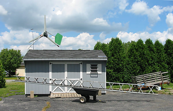

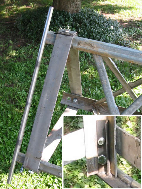

After looking at pictures and getting what info I could, I put this pivot together to tilt up my tower:
(tower pic here)
I know it doesn't look like much but after looking at the pictures, I took everything that I couldn't figure out what it did out of the design. :-)
There's 1" x 1/8" angle iron on 1 1/4" x 3/16" bar and a 5/8" rod. (I think that the
strap" going around the tower is part of the climb-guard. It fits nicely there so I figure that it belongs...)
It only looks like half a hinge; I'm thinking I just need two threaded J-rods on each side in the concrete; the pivot rod will go between them and then I'll bolt a bar over the top of the rod to hold the pivot (and tower) down.
 - Ed.

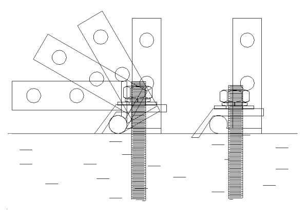

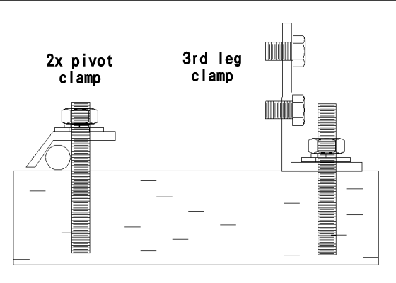

Here's a drawing of what I'm planning at the concrete base to hold the tower.
Just loosening the pivot clamp a little should allow the tower to tilt.
Originally I had thought that I'd need two rods in the concrete per side with a strap across them to hold down the pivot. Now I think that a piece of angle iron will do to contain the pivot rod. Installed as shown, the force against base while raising and lowering the tower will be towards the  j-rods in the concrete, not the (slightly) loose end of the clamp, so the pivot should stay in place with just the one rod per side.
Sprained my ankle though, so it will be a while before I'm in shape to dig a hole.
 - Ed.

I figure the tower weighs a little less than 100 pounds and the mill and pipe on top of it are another 100 or a few pounds more. The tower is 24 feet; the mill with be up another 6 feet on the pipe. The tower will be bolted to my workshop about 12 feet up.
The steel pivot rod is 5/8" diameter. What I was thinking was that most anchor bolts I've seen were 1/2" or 5/8" so I figured (guessed) that the pivot didn't have to be any bigger...
Comments are appreciated!
Thank you,
 - Ed.

My math says (conservatively) that the 5/8" rod has a shear strength of about 8000 pounds. Lifting the tower up can't generate that kind of force but a 250 pound sideways force at the top of the tower while it's being lifted could. But the weight of the tower and mill could only generate half that force. That 2x safety factor combined with the conservative rating of the rod gives a safety factor of about 4x. I might want a higher factor in a public setting but I think (guess) that that's enough for my backyard. Well, that's if my engineering is worth the pixel dust you're reading...
> You can see the flex in the 3 inch angle iron legs [...]
It's possible that my tower is stiffer. I haven't seen any tendency for it to flex yet.
Also, I don't think that the weight of the tower and mill (also a 10 footer) will flex the rod because the rod is supported along it's entire length and range of motion directly on the concrete.
If you can imagine that the following drawing is an end-on view of the bracket, then it shows the tower and bracket at 0, 30, 60 and 90 degrees.
This is the main reason that I didn't put the rod into a hole drilled into a stationary piece of metal, then I'd have to wonder about the strength of that piece as well. But since it's not there, it can't fail!
Well, that's my thinking-slash-design-strategy. I'm not saying that stronger isn't stronger but that would still leave me with the question of what's good enough.
Thanks again,
 - Ed.

Why didn't you get a 1" pipe, which costs about the same at the hardware store?  Much stiffer, stronger - more meat for the abuse a tower must take.
I looked at your pictures, and the bent pole over your garage sort-of stands out as a warning.
I can't guess how you will be raising/lowering the tower with it all beside the garage like that.  Swing side to side?  Pull up against the roof of the shed?
The tower will go against my workshop, a 24'x32' building, not the shed in the picture. I'll reinforce the workshop wall, like I did in the shed, and use a pulley to redirect a winch cable off to the far side.
