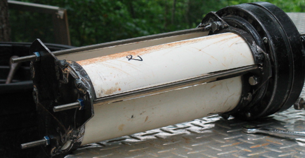

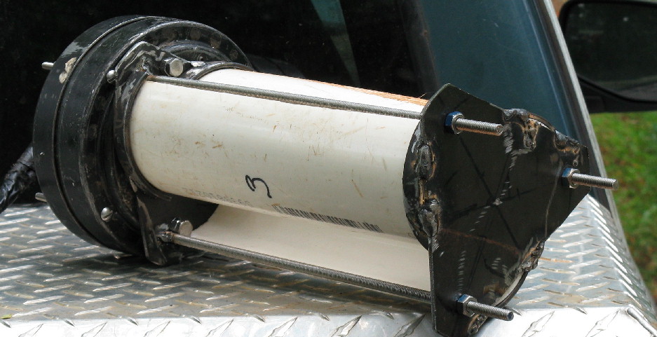

I 'm tearing this unit down one more time for a grinding and painting . Installed just behined the front bumper I takes off at 30 mph and is quiet enough at 75 I don't hear it at all I neeeded higher  voltages for the HHO Cell to get the volume up with distilled water . I thought it looked so much like a Vawt you'd get a kick out of scaled down 120 degree blade configuration.
The stator is tapped 6 times at 20 and 30 ohms per . It runs 10 to 75 volts around 1 to 1.3 amps per tap . The taps are rectified and paralleled and series in over battery voltage  . The cell is on a lawton pmw at 2. 5 to 4 amps(when it gets hot ) with good volume .

Here's b side
« Last Edit: August 24, 2008, 01:28:24 PM by tecker »

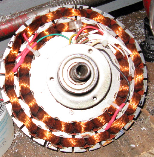

Do you have any pics of the PMA or the gen guts before it was covered?

Re: High speed turbine
« Reply #3 on: August 24, 2008, 02:39:09 PM »
 I'm taking the gen down for varnish and paint I'll take some.

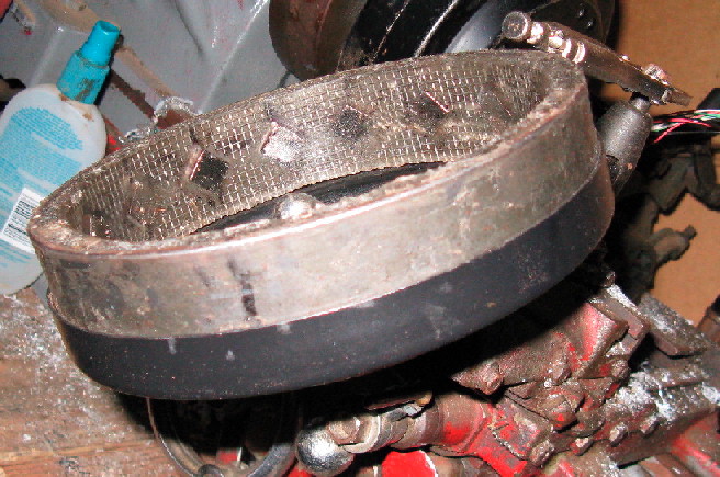

The rotor and stator .I screwed up the wire hauling it around a mounting it in diferent places . Replace that  urethane the stator and several coats of pint and a sealing disk on the mounting side

 Stator I hit the wong button

hey tecker ,
i had to do a bit of you tube research to figure out what your post was about .
nice use of a cieling fan/savonius
does the  pwm work with various input voltages?
