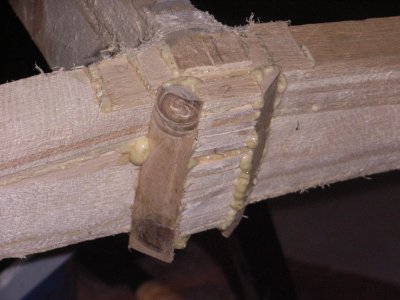

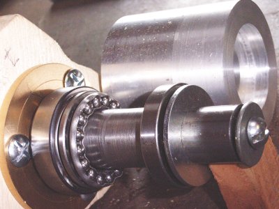

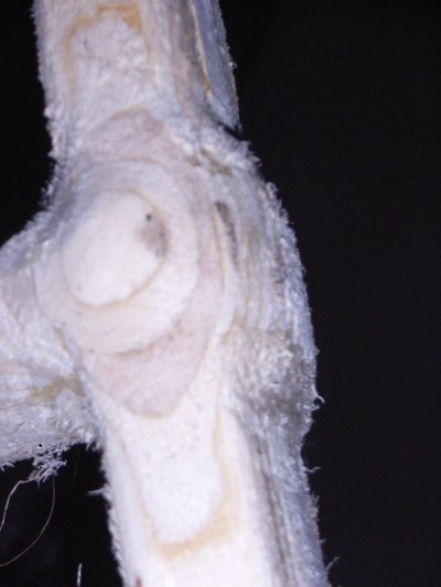

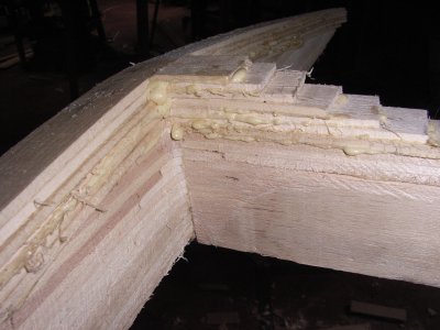

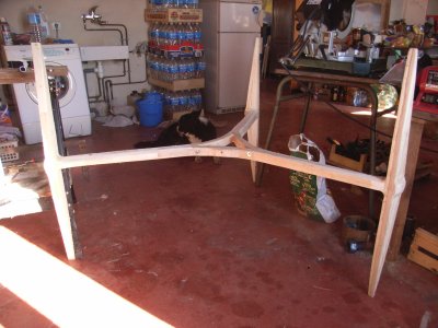

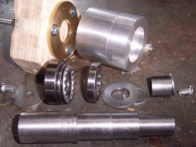

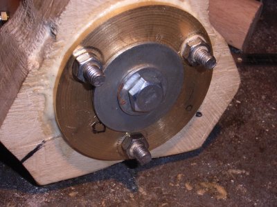

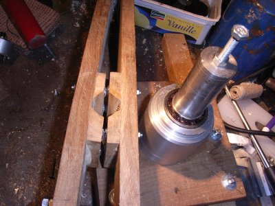

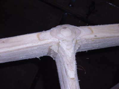

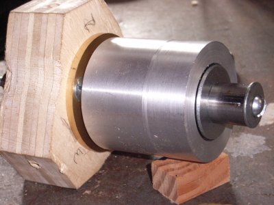

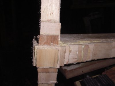

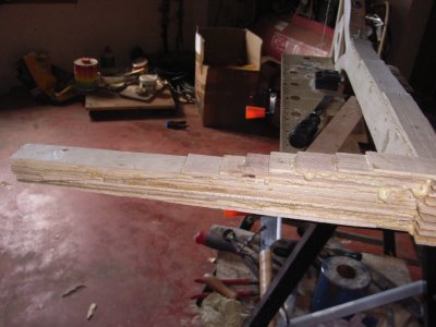

progress on the rotor is not spectacular,did some lathework too.
I hope the images told the story.If something's not clear,ask and I will explain.

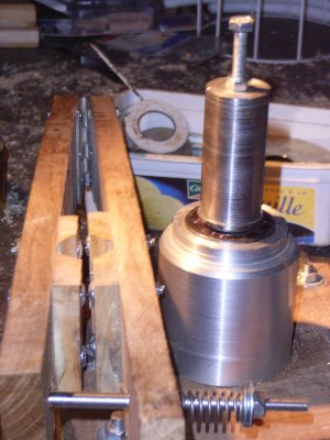

There is a ring of the thrust bearing missing on the images but it got stuck in the bearingholder,because it was fitting well,on the right place,no need to get it out again.

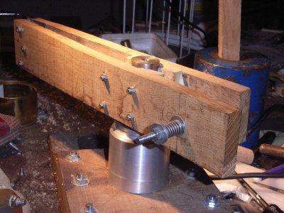

There are some images about the prony-brake too.In fact this was my first lathe-exercice.the bearings is the same as for my vawtrotor,although the thrust bearing  is somewhat overkill it was just an exercice for the 'real' bearing-version.
In fact the idea for the pronybrake was based on flux and wundstuffs idea 'clamp the shaft between two pieces of wood'
I tried to do this the right way.We'll see if it will work.
In the lath I veryfied that the braking force can be adjusted well with different speeds.What I don't like about mechanical brakes is that braking force is not regularly going up with speed so you probably have to adjust it veryu often.

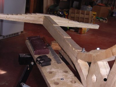

some more pics

"progress on the rotor is not spectacular..."
Perhaps not yet, but it will probably look spectacular when you're done.
Nice woodwork.  Because VAWT's haven't been perfected nor optimized, there's lots of room for artistry.
Am I correct in believing that the brake attachment will be replaced in the future with a generator attachment?  If so, then will you support the rotor with a large box attached to the aluminum cylinder, with the generator inside the box?

Hi Stone
 What's your thoughts for the blades?
 Nice Job !!
« Last Edit: August 25, 2008, 04:43:08 PM by vawtman »

« Reply #4 on: August 25, 2008, 07:17:59 PM »
 It's a big unit and heavy  I 'll bet . Your way too far to turn back now . great project .

« Reply #6 on: August 26, 2008, 04:21:45 AM »
Hi v.m.
The 'blades' will be attached to the deltas that you see on the extremities of the arms
It will be constituted of two bambou 'masts' and a sail of very light tissu(I have some  parachute tissue)The resulting 'blade' will be a delta of about 3m high (10') and 40 cm wide (1.4 foot) in the middle(level of the arms).
With a rotordiam of 1.40m (4.7 foot)  the height of 3m seems extreme,but I hope reducing the weight of the blades to the extreme it will be safe,without dangerous vibrations,and for a vawt a very good rpm/torque ratio.

Hi s.w.
The next step (building the blades,see my response to v.m.)will be very spectacular.
The aluminium cilinder with the bearings will sit in a steeltube,that will be attached to the tower.The pronybrake will be sitting on the ground(need for continuous adjustment)The shaft going down must be stiff and light (again),to avoid extra bearings.I'm thinking of bambou again.
If you know a bambou 'forest',bambou sticks have an unbeatable stiffness/weight/price ratio.
I hope the pronybrake tests will allow the decision if it's worth building a alternator,kind of systematic aproach.

Hi tecker,
Yes I see it big,but not heavy.
