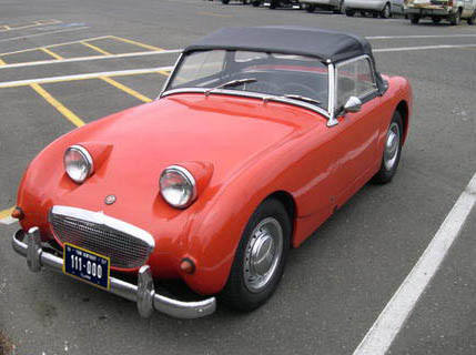

« on: September 22, 2008, 02:31:51 PM »
ell, many of you know me, from my comments that I've made and my presence in the past year on the IRC channel.
 I figured it was about time that i got on with a project of my own.
 So i decided to convert my old '59 Austin-Healey MK1 "bugeye" to run on a renewable fuel.
 Since i have brewed alcohol in the past and this particular car is a real good candidate to convert, I decided to proceed.
 The first steps was readying the fuel delivery system to handle alcohol.This entailed replacing all the sections of rubber fuel lines with more modern stuff, and replacing the old tick over diaphragm pump with a newer one. That handled the problems pretty easily as most everything on this old car is easily accessible (if you don't mind bending over a lot)
 The next step in the process was increasing the compression ratio. Fortunately this car already had a set of high compression pistons and racing rods installed several years ago. So i was already at 12:1 comp.ratio. To increase it further i took a spare head and had it milled down to increase this ratio further to 14:1.
Then since my first batch of alky wasn't ready i purchased some for testing purposes.
tuning this particular car to run best off alcohol is quite easy, It entails adjusting the movable needle to increase the fuel flow. (this car uses two side draft carbs), and setting the timing to the optimum advance. All this was done by "feel" as I've been playing around with old English sports cars for years.
 With straight gasoline this little 948cc engine was able to achieve upwards of 60 mpg, now to see what i could get using an alternative fuel.
 My first road test after run in and primary adjustments (I was also doing some tweaking while out) gained readings of 122 miles on 2.5 gallons. I did this by running the tank dry. Not bad! All in town and stop and go driving and my first run achieved 48 mpg!
 For now I'll call that a success!!

How do you keep water out? I used to have a 2 liter 1972 Pinto. Had a rubber band instead of  a timing chain like the British Cortina 1.6 liter that was also used. It would run on 95% isopropyl (print press alcohol), but the next day wouldn't start because the carb bowl was vented and moisture condensed in it overnight.
The compression was only about 9.x, but that was still high enough to require 'high test' gas in the US.

 Water from condensation can be a problem, it's one reason i start out with 180 proof ethanol. That will absorb the moisture from most normal situations, without imparing performance.

The quickest way is to add a little bit of dino fuel. The petroleum distillates keeps the Alky from condensensing water into it.
The funnest part is to take the Alky out of the freezer, and watch as the water around the outside attaches to the container.
The Alky being hydroscopic (<-sp?) is what causes it to suck in the water vapors.
The higher the proof the harder it is to keep it from happening.
Zeolite is good for keeping the water out until usage, but I've found that even a small amount, 1 gas to 20 Alky keep it from having problems.
I like zeolite, but don't have enough to keep more than one batch in it, so I've gone to mixing as little gas as possible.

I must say you took it as far as I ever would. 14:1 is about it for even those old iron engines without some serious extra work on the rest of the lower end, and some attention to the pistons and spark plugs.
Your numbers seem to be right inline with the general average when switching from dino to Alky.
If you're going to run only Alky, and stay with the carbs, you could even run it as low as 160P, but in the winter you may have problems with starting.
How's the peppy-ness of it? shouild scream with the higher 14:1 and a cold running fuel.

 In regards to the strength of the engine, I really have no major worries there. The "peppy-ness" has improved over the standard gasoline responses. I didn't do any 0-60 testing, but this has always been quite a fun car to drive!
 The crankshaft is not stock, btw that was replaced with a stronger version years ago.
There is the fact it is only a 3 main crankshaft, still but I'm not racing this thing so hopefully it will stand up to the additional stresses.
 I've worked with sports cars for years and have rebuilt literally 100's of the A series Morris engines. If this was the 1295 variant i would be much more worried at running so high a compression ratio on it.
 I am still hoping for more fuel economy and I may play around with electronic ignition to see if that helps. At least changing the timing curve would be more stable! I am also considering using a re-configured camshaft to tweak the performance # a bit more.
 I will be adding 1 or 2 % gasoline to this fuel, primarily to denature it so i can stay legal in this implementation.
 As far as adding any form of injection first the costs would be up there and I like the looks and the tinkering required by the original dual carb setup!
 One thing about this setup, it will be easy to convert it back to gasoline in the future if i so choose to do so, I'd just have to replace the head with the one i just removed.
