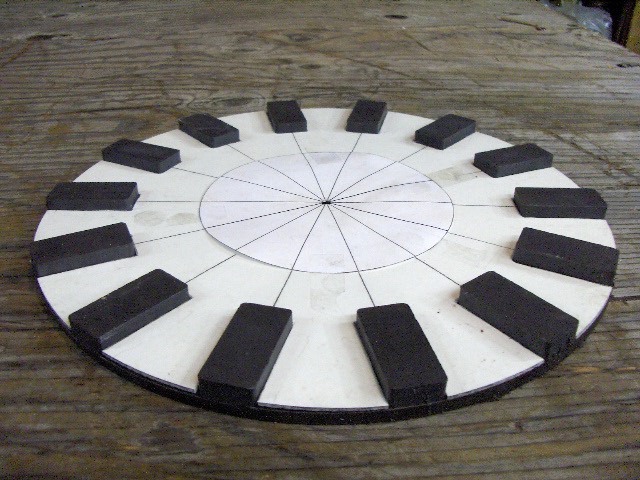

Well at least the planing stages. I've been collecting parts and talking about this project for over a year or so.
This wind generator will be a dual rotor with 12" discs, 14 Lowes 1-7/8"X7/8"X3/8" ceramic magnets.
Reason for the cheap weak magnets is incase this thing is a total flop.
I had built a smaller version a couple years ago and it worked quite well.
At least long enough to do a truck mounted wind test. Befor I had a chance to tower mount that one a customer talked me out of that one for his 8ft watter wheel hydro project.
It was smaller then this one with 10" discs, 12 same Lowes magnets per disc and the standard 9 coils (Jerry Rigged).
I've had a chance to start construction. I've started the stator for the 11 coils of 24 ga. / 300 turns each and the .25"X12" steel magnet discs.
Here a couple pictures of whats done so far.

whats the set up on the coils--each with its own rect. ??
2&2 or 3&3??wont there be a lone coil on its own??
cant be a single phase set up??hmmm........
or did i miss one of your posts??

Hi hiker.
Well actuly this system is 11 single phase power supplys. The wire ga. is small and the turns count is very high. The magnetic flux is weak using ceramics. THats another reason for the high turns count.
Yes each coil has its own fullwave bridge diode. This eliminates any slight diferances between coil. No heat producing friction here.
Each coil Produces charging voltage. So basicly each coil = its own fullwave bridge rectifier and is a small battery charger independant of the other 10 (11 total).
If each littel charger produces 1 amp then when all 11 are added together (dc output of each) the total sum is 11 amps.
Each coil see,s a steady flow of N,S,N,S magnets pasing by. Thene it produces power.
This is what we do when testing one coil to find turns count, rpm , voltage and other info when designing a dual rotor wind generator from scratch.
I simply make this coil with high enough turns to produce cutin voltage by its self.
The coil count then is not an isue, only physical room and magnet orentaion over the coil and its leggs.
Think of it this way. So I go to Wallmart and buy a 1 amp tricle charger. I find that I need more amperage. So I go back to Wallmart and buy 10 more. Then I hook all 11 up to the same battery. Now I'mm charging at 11 amps.
I could use 1, 2 , 7,20 or how ever many chargers I wanted. They do not interfear or bother each other. The total count only effects the amount of charging power available.
So with Jerry Rigging of this type the only restrictions are more phisical then electrical and the magnets must be even #s of N & S not so with coil count. Coil count can be what ever fits.
I'm convinced that the great thirmal demize (burnt coils) of the star alts is the wiring of coils out of phase in sires then connecting them to the same load.

OK some progres today. Cut the holes in the stator forms. One for the coils and one for the iron core center test.
Also gluded the magnet templates to the magnet dics. I will try to glue the magnets tommorow.
Maybe a couple pictures tommorow? I might sift out some iron dust. Might even mix it with some reson and pure that into the stator form? Time will tell?
