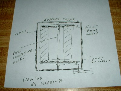

« Reply #6 on: January 08, 2009, 03:15:15 PM »
Norm,
Here's an idea I've thought about for a couple of years but never got around to trying.
Use a couple of bicycle wheels for the top and bottom wing mounts, drive the motor off of the bottom rubber tire. Depending on the diameter of the tire you will get 2X:1 gear ratio.
P.S. Just got back from two weeks in St. Pete, Fla. 70's almost every day.
Now I wake up to two inches of snow on frozen roadways. Blah!
Fishbonz
« Last Edit: January 08, 2009, 03:15:15 PM by FishbonzWV »

Re: Inspiration and morale needs a boost
« Reply #7 on: January 08, 2009, 03:18:05 PM »
bonz;
Gotta love that DanCad, very useful tool.
« Last Edit: January 08, 2009, 03:18:05 PM by TomW »
« Reply #8 on: January 08, 2009, 03:29:48 PM »
Yes George, :-)
I hope I didn't infringe on his patent rights!
Bonz
« Last Edit: January 08, 2009, 03:29:48 PM by FishbonzWV »
« Reply #15 on: January 09, 2009, 11:53:15 AM »
Fishbonz,
  Yes, I've thought of that also...In fact, I've
done the bottom half.,  but friction drive sucks !
here's a better idea...kinda like gear drive...
wrap a bicycle chain around the tire...just a
little smaller in diameter than the tire when it's
inflated...position it...then inflate the tire.
....make sure the tire will stay inflated for a
long time....maybe put some 'slime' in it.
 20 or 16 inch tires ought to work okay...the
large rear sprocket or the small chainwheel of a
10 speed ought to work about right on the generator
.....(FritzCad is an older inferior version of DanCad)
Sounds like another project to start this summer
that will work in the winter...which is what I
should have done......
« Last Edit: January 09, 2009, 11:53:15 AM by Norm »
