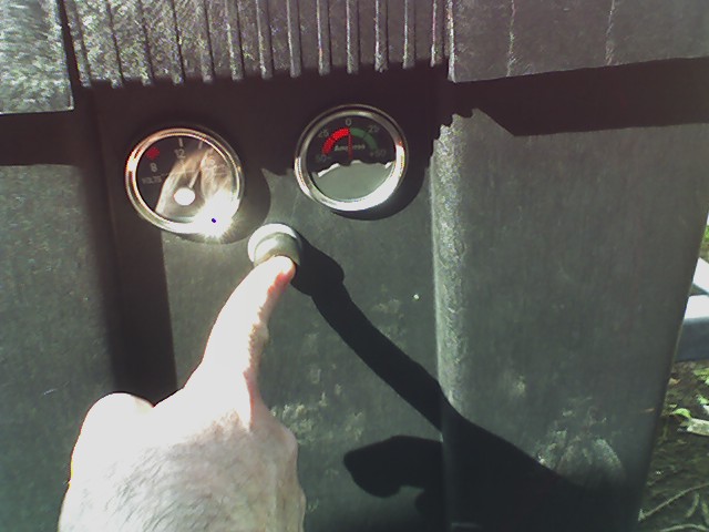

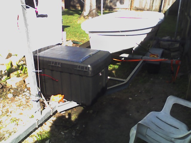

I finally made a little more progress on my power trailer.
I got a good sized plastic box mounted in the front to hold the batteries and electronics.
I gave up on my 40 watt panel as the 1'x4' size was problematic.  I instead settled on a 30 watt panel which is a much better fit.  You can see it mounted on the top of the battery box.
I also mounted volt and amp gauges in the box.  When you press the weather proof button, the voltage gauge is powered up and the lights on both gauges turn on.
I'm happy to report that, on the infrequent occasion that the prevailing winds manage to miss the 40' trees surrounding my 22' tower, the Air 403 seems to work properly.  I expected it would, but after its undersea adventure and two weeks soaking in sand and salt water I am happy to be able to confirm that it can make a measurable amount of power.   It only spun up to speed for about 10 seconds at a time before the turbulence would turn it around backwards, but in those brief periods it would produce 5+ amps.  I expect that once the trailer is in an unobstructed location, it will work well.
My plans currently call for 2 210 AH 6v golf cart batteries but right now I only have a single 25 amp hour battery. The picture above shows it is getting overcharged by the 30 watt panel.  I put a 100 amp load on it for 30 seconds after that picture was taken.  Once the load was removed, the voltage had dropped to 12.5.
I also have to say that I am very impressed by this panels ability to produce voltage in low light.  When hooked directly to my battery load tester (load off) the voltage gauge was pegged at 16+ volts.  I had to turn the panel upside down, place one edge on the ground and lower the other side to within 2" of the ground before the voltage dropped to a measurable number (<16).
I'm going to start working on mounting the lawnmower generator next.

Great looking setup! but I wonder if it is a good idea to have the solar panel mounted to the black cover or does it have standoffs to give air movement below?

Standoffs to allow for air circulation around the panel are likely a good idea because as the panel heats up its output voltage will drop.  For most 36 cell panels this will not be much of a problem, but in your case, I would also wonder about the aging of the panel from the heat.  My old epoxy coated panels which look similar to yours have yellowed a bit on the epoxy, probably from UV, but I have seen some small cracks as well, and can't help but wonder if temperature extremes were also a contributing factor.  I have a definitely developed a preference for the (tempered glass-EVA-Cells-EVA-tedlar) type of construction as unless you crack the glass, or gouge the tedlar on the back, they seem to hold up pretty well, and for them to work out economically for me, they need to last a very, very long time.  Rich

The panel has small standoffs.  The rubber grommets in the bolt holes hold it about 1/4" off of the top of the box.  It is an epoxy coated panel on an aluminum backing.  I think it is a "Solarex"(?) brand panel.  Anyway, it is an old panel, but it has never been used so it is "like new".
Yes, I replaced the bearings and bought a new set of blades from Southwest Wind Power.  I am also amazed by how little damage it sustained.  When I told the people at SWWP what had happened, they said it was probably a lost cause and not worth the effort to try and fix.  I'm glad I didn't listen.  :)
