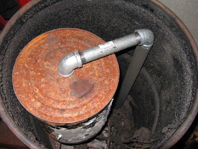

I added a five gal drum inside the loader to get it to run clean in heater mode . I haven't had time to get to the metal furnace .It's really cold now and the extra heat is a good thing .I was struggling to get the flue to run smokeless but the temp was running hotter in the front of the drum hence the 5 gal placement .Works good here's a Youtube Ignore the siding damage It was cold when I put in that vent I botched the siding I'll get it when it warms up. I'm going  add  10 ,130 Watt peltiers to the flue
http://www.youtube.com/watch?v=U8lBdprRTOY

Trecker,
Thanks for sharing. Can you post a picture or sketch so we can guess what is happening?
Nice low or little smoke fire, BTW.
